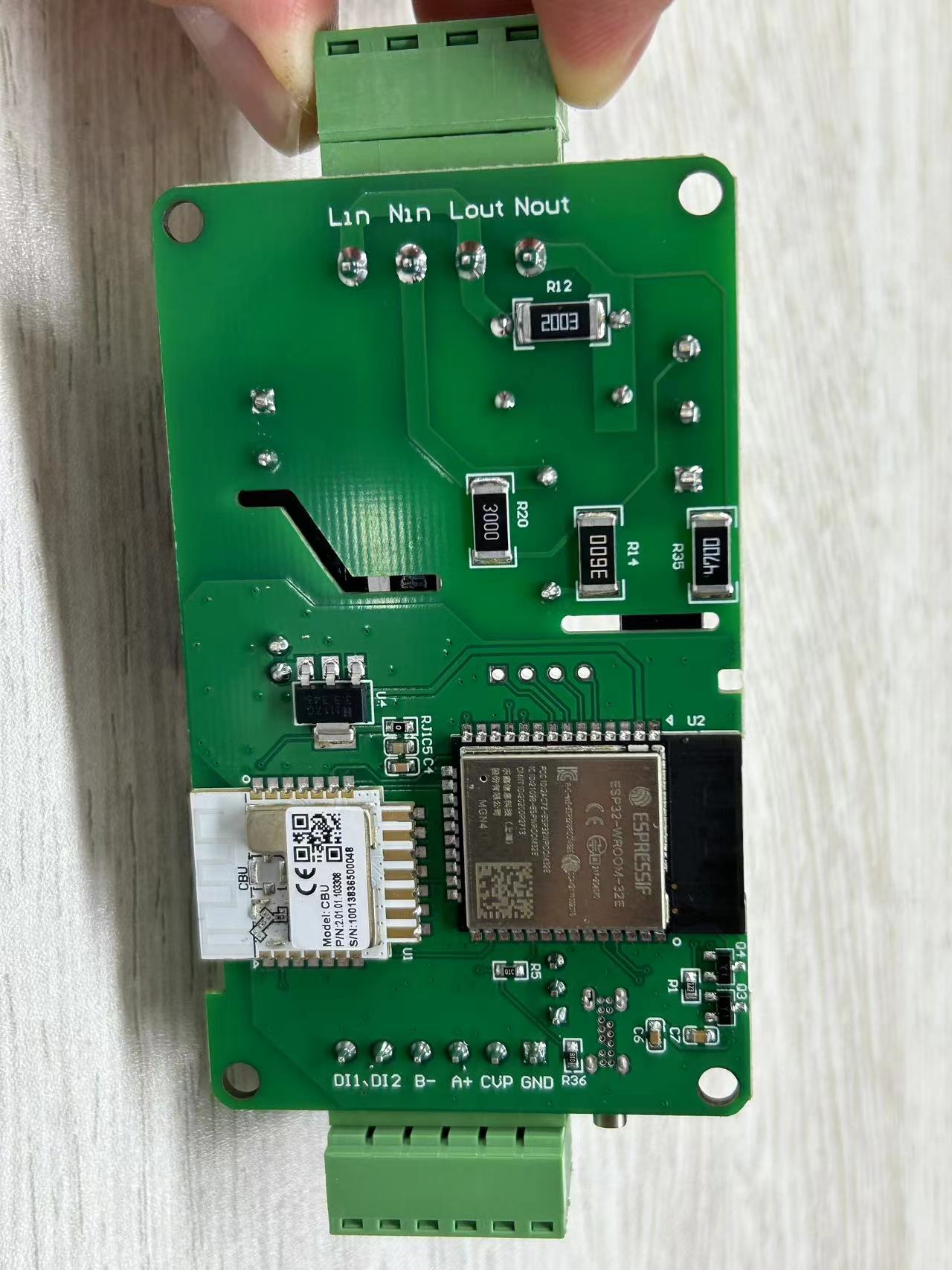

hardware design is completed. Now testing with KCS firmware. home assistant is tested , it's OK.
the TRIAC use 40A IC, but actually use 2-3A is safety, large current will be hot , need add heatsink for TRIAC.
Support Tuya app, home assistant, digital input manual control and ESP32 RS485 modbus, wifi by MQTT, HTTP, TCP command.
maybe next week will make YouTube video tour.
