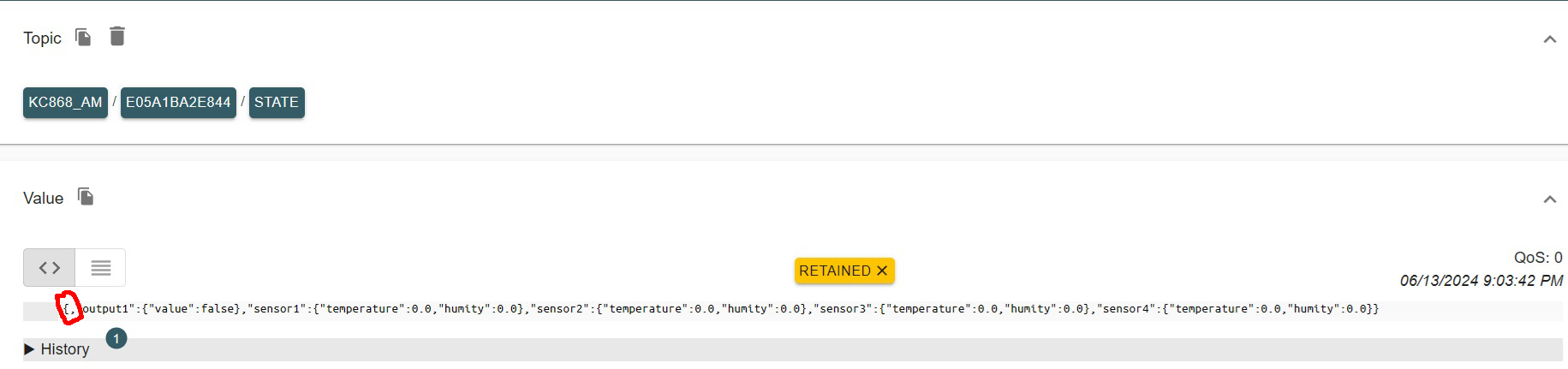

Don't use WhatsApp. I have attached two pictures of my configuration. Works fine with ESPHome, but I want to use KCS firmware because I like the extra features it has.
I have noticed in MQTT Explorer that the published MQTT string has an extra comma before "output1". {,"output1":{"value":true},"sensor1":{"temperature":78.3,"humity":-100.0},"sensor2":{"temperature":78.8,"humity":-100.0},"sensor3":{"temperature":78.6,"humity":-100.0},"sensor4":{"temperature":78.6,"humity":-100.0}}
This seems to affect the JSON format so I don't know if it is supposed to be there or is it a bug in the firmware.
I have circled it in red in the image.
