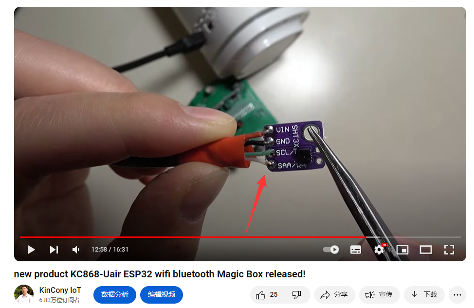

i think it's i2c extend usb cable pins define problem. before i am using 4-wires USB mini cable in YouTube video. here is photo:
But now you are using 5-wires. Here is our PCB usb pin define.can you use a multi meter to check whether the vcc,gnd,sda,scl pin is connect correctly. also make sure you have connected with correct USB port of Uair box.
