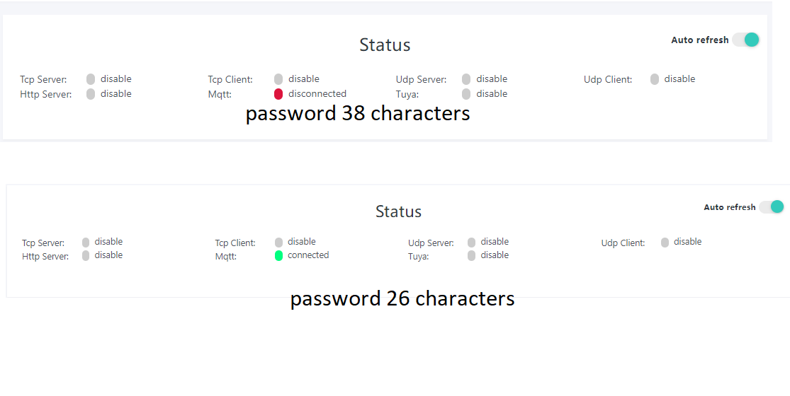

I have the Kincony A6 firmware V2.2.2 card and the Mqtt Broker does not connect with a 38-character password. The problem is not with the broker, I have already tested it on another broker with a password of 28 characters and it works, and as it is an IoT application, I cannot change the device's password, could I update it to accept a longer password?
