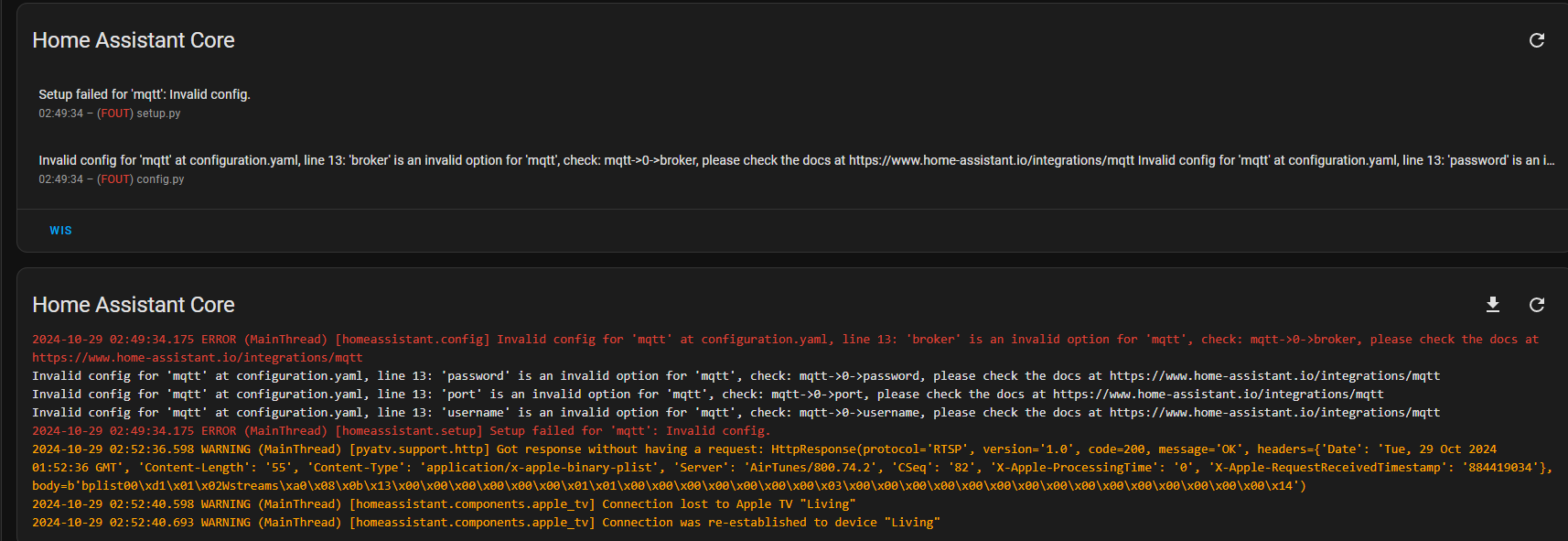

Instead in the log files I get fault messages on the configuration code:
Logger: homeassistant.config
Source: config.py:1300
Invalid config for 'mqtt' at configuration.yaml, line 13: 'broker' is an invalid option for 'mqtt', check: mqtt->0->broker, please check the docs at https://www.home-assistant.io/integrations/mqtt Invalid config for 'mqtt' at configuration.yaml, line 13: 'password' is an invalid option for 'mqtt', check: mqtt->0->password, please check the docs at https://www.home-assistant.io/integrations/mqtt Invalid config for 'mqtt' at configuration.yaml, line 13: 'port' is an invalid option for 'mqtt', check: mqtt->0->port, please check the docs at https://www.home-assistant.io/integrations/mqtt Invalid config for 'mqtt' at configuration.yaml, line 13: 'username' is an invalid option for 'mqtt', check: mqtt->0->username, please check the docs at https://www.home-assistant.io/integrations/mqtt

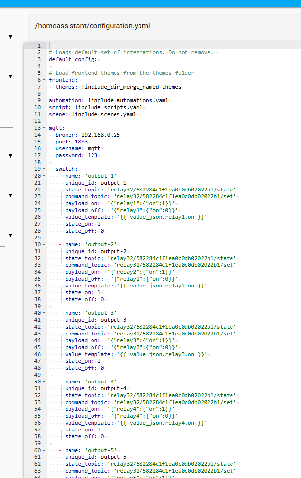

In the file editor I added the configuration code with the Broker IP adress of the Raspberry pie 5 it's running on, and filled in the correct UID.
Here is what I filled in:
/homeassistant/configuration.yaml
mqtt:
  broker: 192.168.0.25
  port: 1883
  username: mqtt
  password: 123
  - name: 'output-1'
    unique_id: output-1
    state_topic: 'relay32/582284c1f1ea0c0db02022b1/state'
    command_topic: 'relay32/582284c1f1ea0c0db02022b1/set'
    payload_on:  '{"relay1":{"on":1}}'
    payload_off:  '{"relay1":{"on":0}}'
    state_on: 1
    state_off: 0

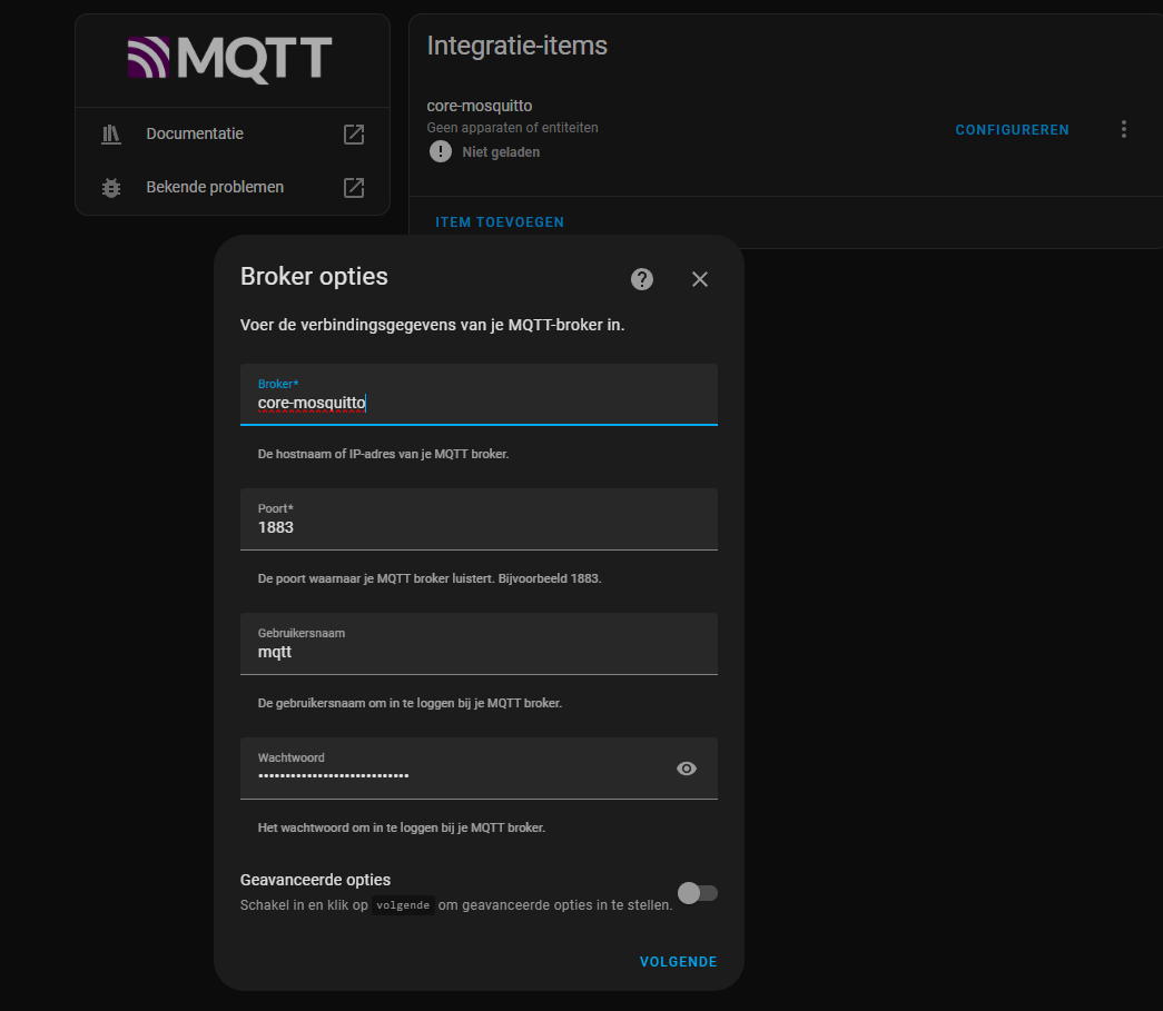

I installed the Mosquitto broker and the MQTT integration I can't see what Im missing here
