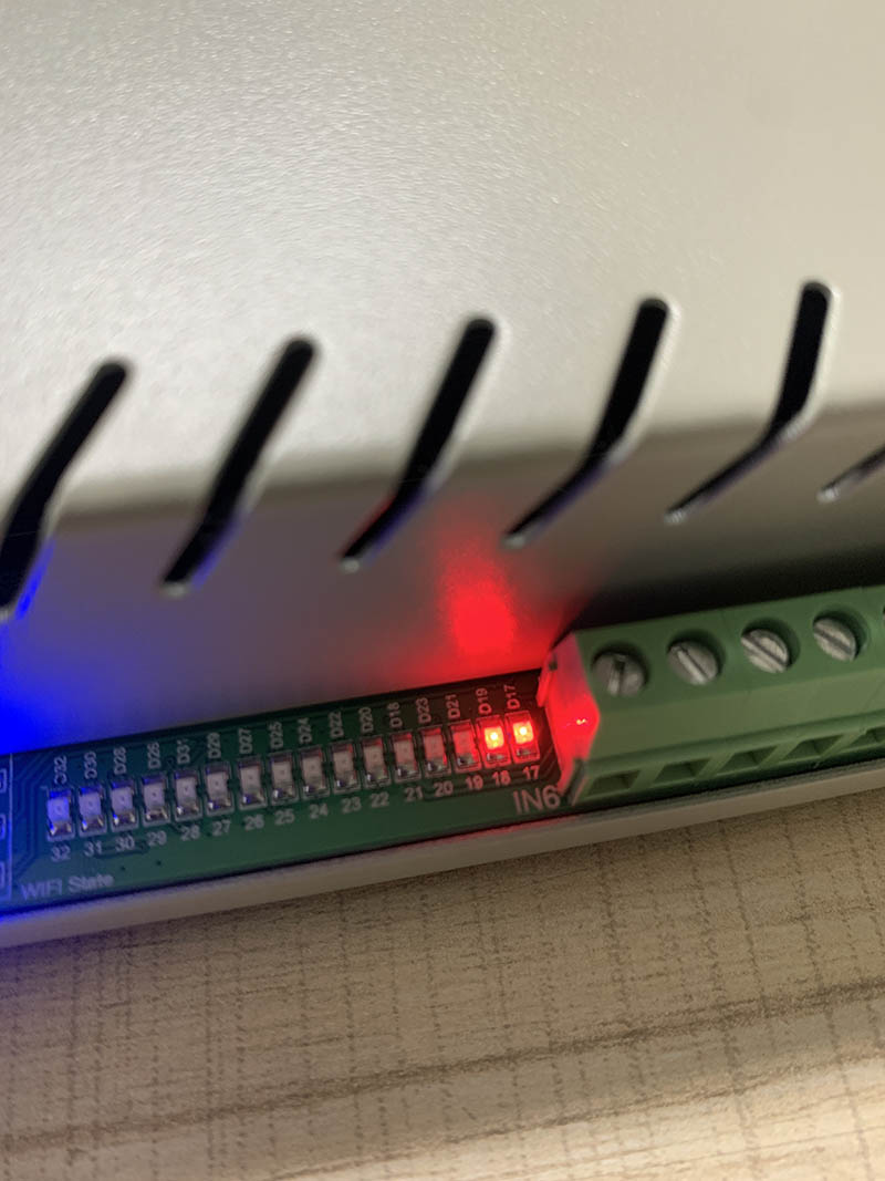

MQTT set issue
yes, support multi-output by one command. you payload should as this format:
{"relay17":{"on":0}}{"relay18":{"on":0}}
