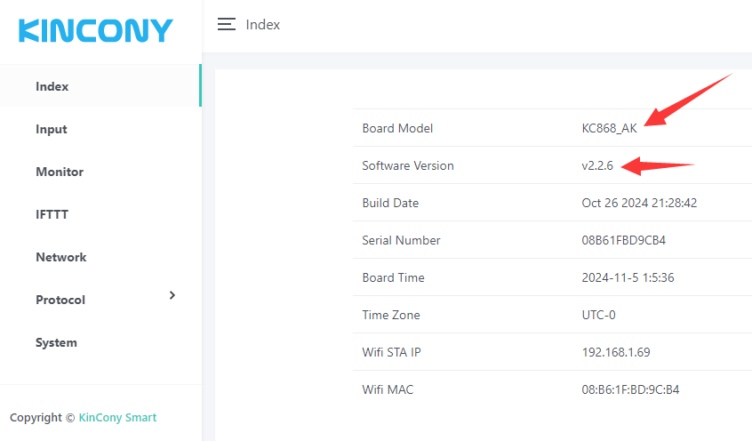

tested with KCS firmware, enabled rs485 modbus as follows, INPUT1 (key1) is no problem. see the photos.
INPUT 1-35 begin with RS485 register 0
tested with key4 ,also is well.  bit "0" means "pressed".
