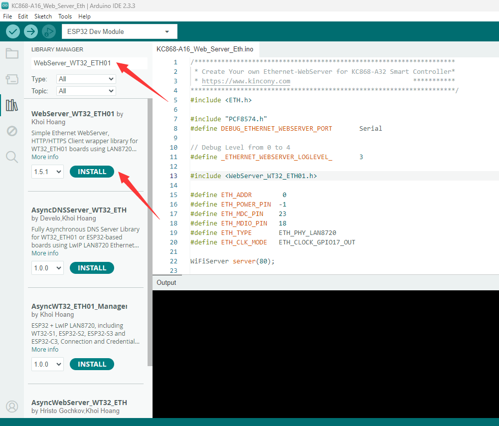

KC868-A16 - Own Arduino firmware
chose NodeMCU32 also is OK. your problem is not installed  WebServer_WT32_ETH01 arduino library. just install it.
