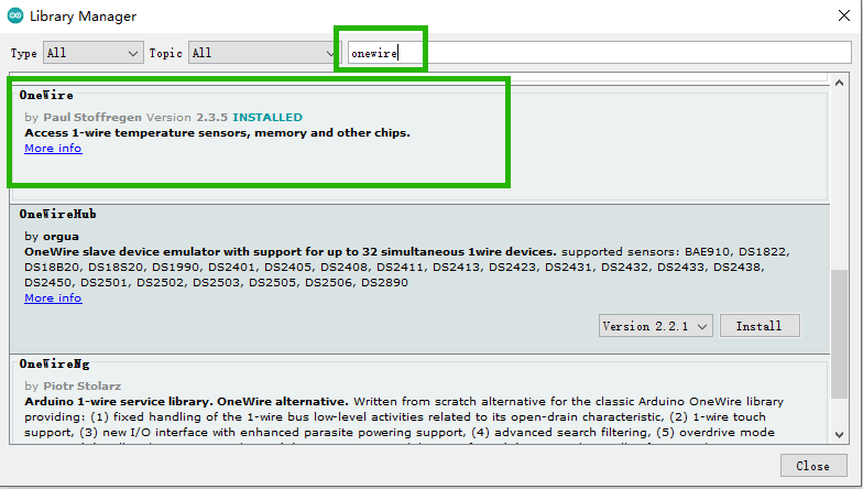

Code 3: //The demo code is DS18B20    You can copy the code to your Arduino IDE
