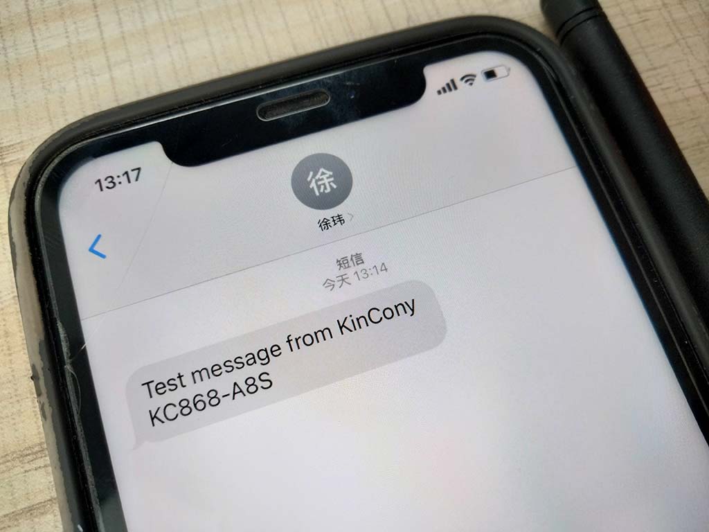

[Arduino IDE demo source code for KC868-A8S]--#12-Send SMS to many phone numbers
This demo source code, you just replace with your 10 phone numbers, then will send one SMS to 10 mobile phone, you can also send to many many mobile phone number in loop() function.

  send_sms("Test message from KinCony KC868-A8S",phone1);
  send_sms("Test message from KinCony KC868-A8S",phone2);
  send_sms("Test message from KinCony KC868-A8S",phone3);
  send_sms("Test message from KinCony KC868-A8S",phone4);
  send_sms("Test message from KinCony KC868-A8S",phone5);
  send_sms("Test message from KinCony KC868-A8S",phone6);
  send_sms("Test message from KinCony KC868-A8S",phone7);
  send_sms("Test message from KinCony KC868-A8S",phone8);
  send_sms("Test message from KinCony KC868-A8S",phone9);
  send_sms("Test message from KinCony KC868-A8S",phone10);
