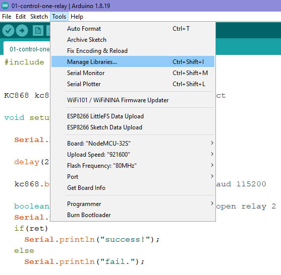

3. Install library in arduino IDE.

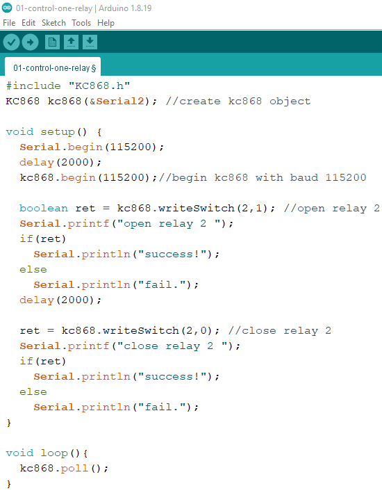

here have many demo simple code for how to use KC868-H32B Pro smart controller's relay output and input sensor port.
This is sample code how to turn ON/OFF one relay.
