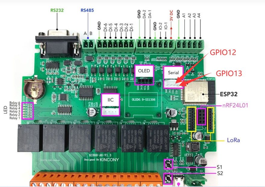

KC868-A6 Digital input IRQ
there is a extend serial port on KC868-A6 board. the free GPIO is GPIO12 and GPIO13, you can use for PCF8574's INT pin.
