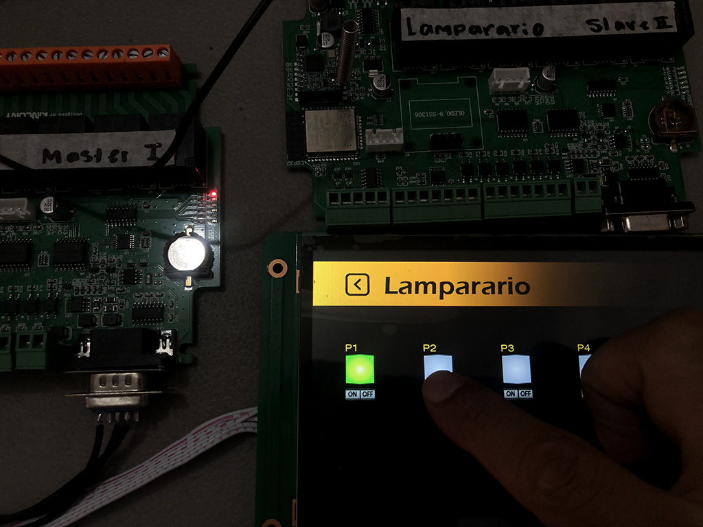

RS-232 - LCD Dwin communication
Okay ! I think I rushed to post! The problem was that I had the connection between the screen and the KC868 [TX - TX] [RX - RX] module, so I had to cross the signals like this: [TX-RX] [RX-TX], sorry, it's solved!
