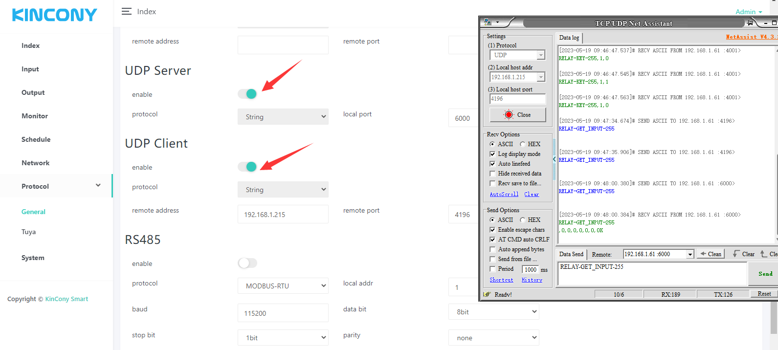

KC868-AI support STRING protocol by UDP. just you need to enable "UDP Server" and "UDP Client".
enable "UDP Server", so that you can send STRING command work with KC868-AI.
enable "UDP Client", so that when INPUT short with GND, just INPUT trigger, will auto send STRING message upload.
