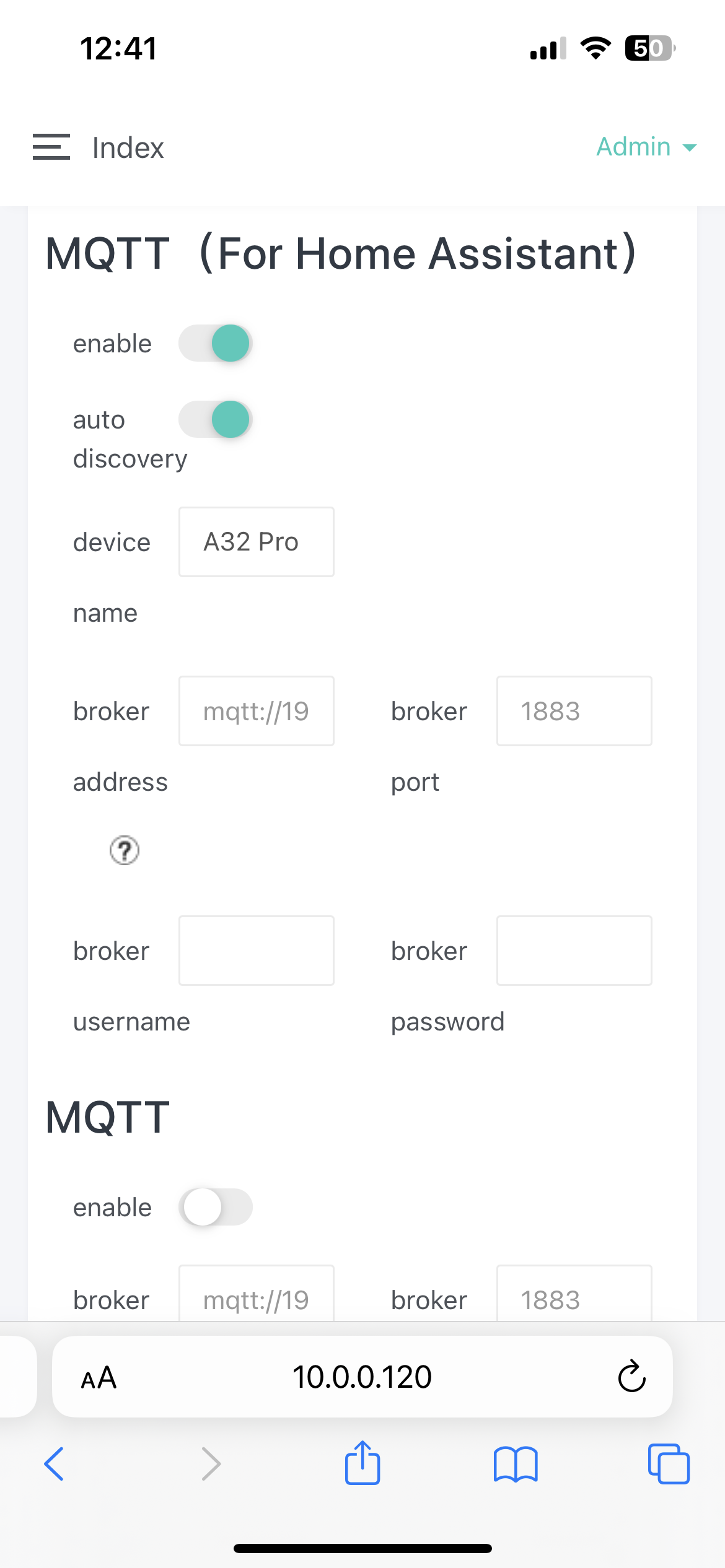

after download KCS v3 firmware, enable mqtt home assistant auto discovery option in "protocol" webpage. it will auto add to home assistant by mqtt.

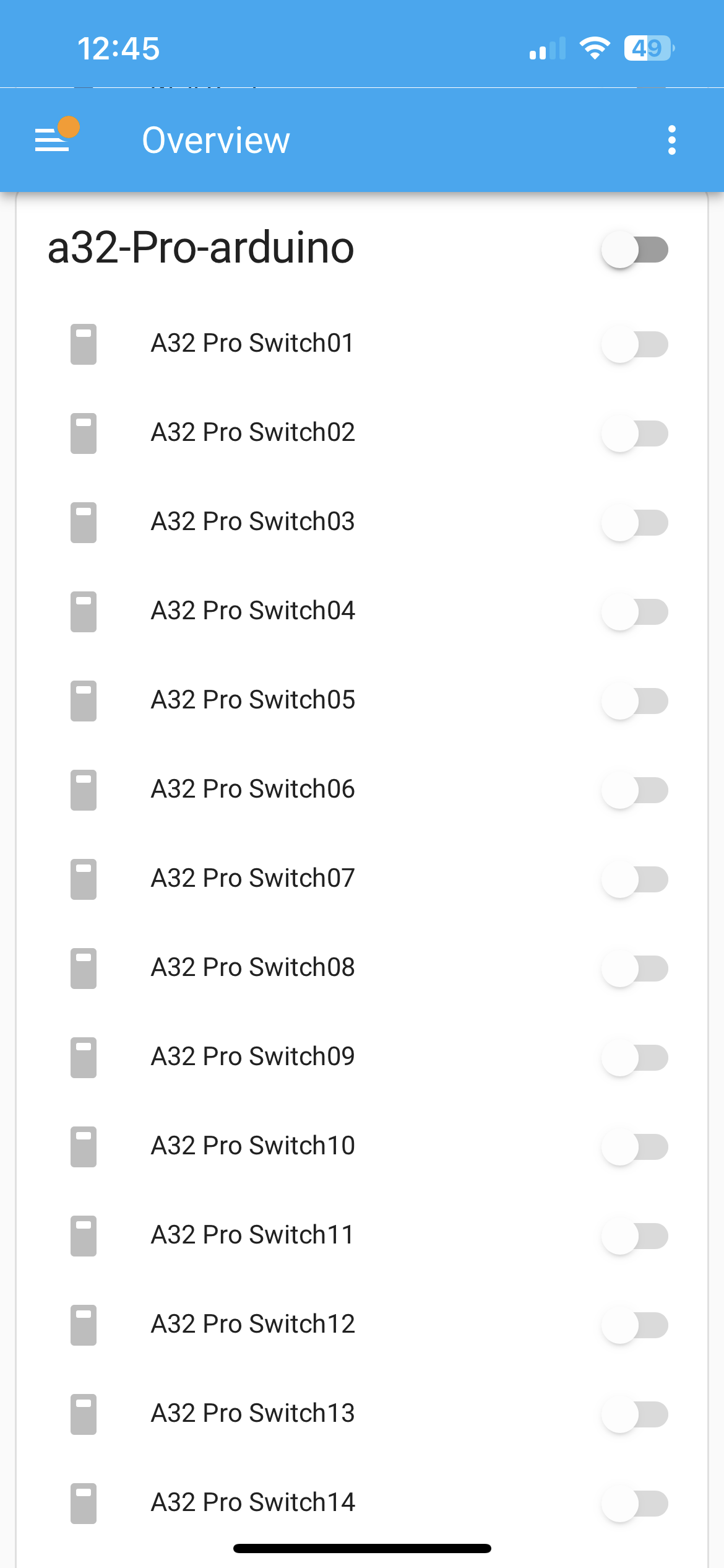

I enabled it and still have no control!!
This is part of my home assistant dashboard

need input mqtt broker ip , port, user name, password.
01-17-2025, 08:27 PM
How can i get mqtt broker ip address?
01-18-2025, 12:10 AM
if you didn't installed mqtt mosquito on home assistant, how to work with mqtt?????
