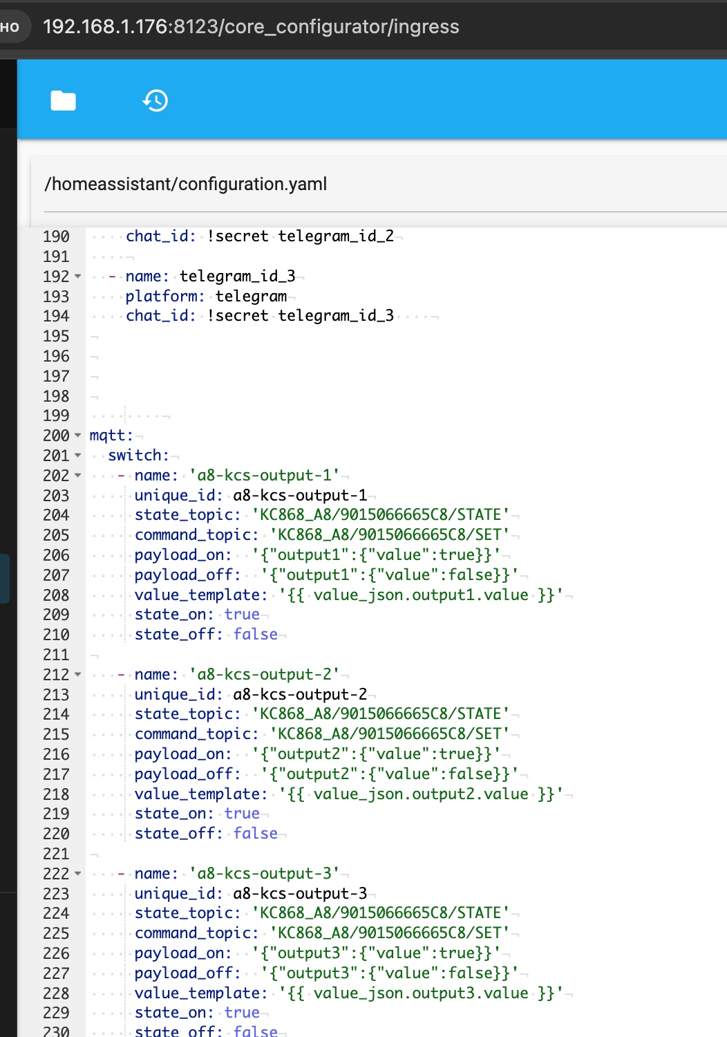

I did everything as you said but the device is not there. Here is a photo Please check

#13
do you have replace the serial number for your own board? it used in mqtt topic.

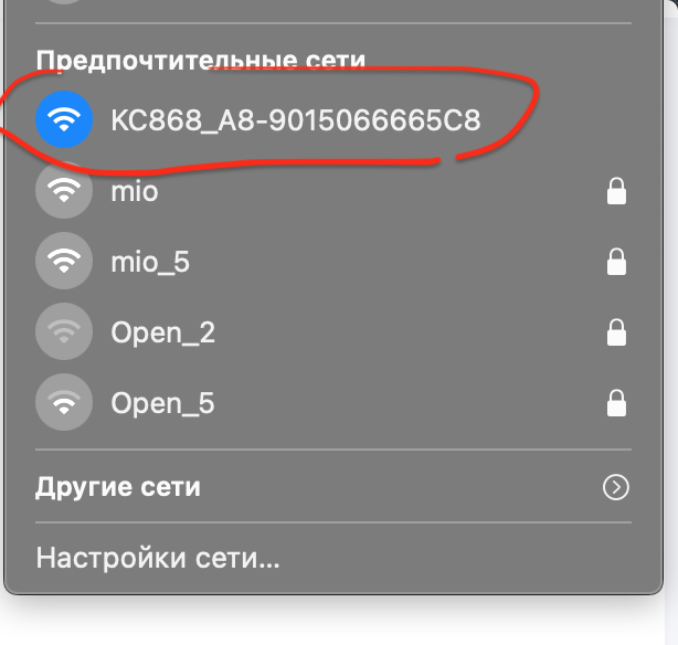

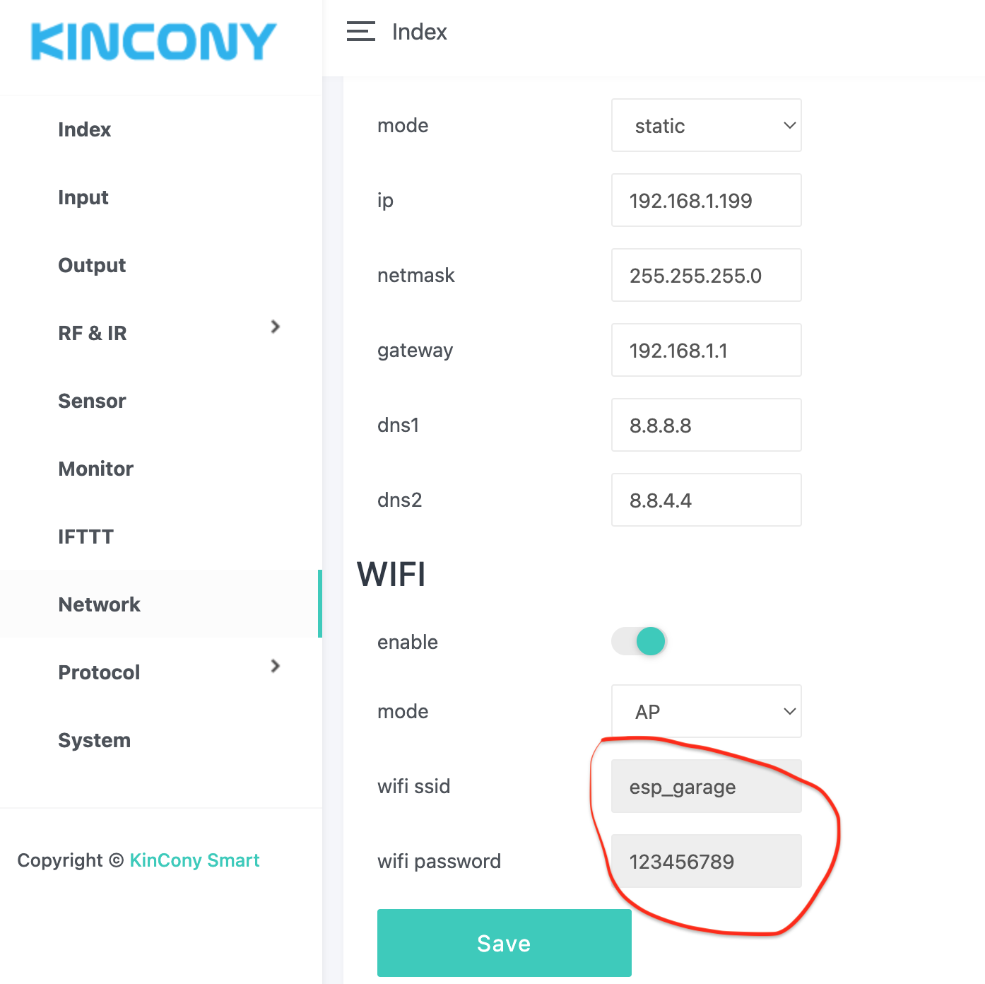

1) I installed wifi ssid (esp_garage) and wifi password, but when I open the list of networks, I do not see the esp_garage network. I only see KC868_A8-9015066665C8. Why isn't my network esp_garage?
 2) When I connect to the network KC868_A8-9015066665C8 the Internet does not work.
I need to connect another ESP32 (wifi) over wifi to this network
Check photos please

if you want use internet, so NOT use AP mode, you should use "STA" mode, so that board will connect to your router.
#16
(02-10-2025, 12:39 AM)admin Wrote: if you want use internet, so NOT use AP mode, you should use "STA" mode, so that board will connect to your router.
My module (KC868-A) is connected via ethernet and I want it to be an access point via WiFi for ESP32 I started this topic with this task!
#17
the AP name can't be changed!
#18
(02-10-2025, 09:16 AM)admin Wrote: the AP name can't be changed!
Ok Thanks but when I connect to the network KC868_A8-9015066665C8 the Internet does not work.
#19
KC868_A8-9015066665C8 is ESP32 hotspot wifi . how it work with internet????? it's not a 4G module! only a esp32!
#20
(02-10-2025, 11:47 AM)admin Wrote: KC868_A8-9015066665C8 is ESP32 hotspot wifi . how it work with internet????? it's not a 4G module! only a esp32!
Thans for information ю If I am using KC868_A8 module that is connected via ethernet. To connect to it ESP32 over WiFi, I must specify wifi ssid: and password. ssid I see (KC868_A8-9015066665C8) and which password to specify?
