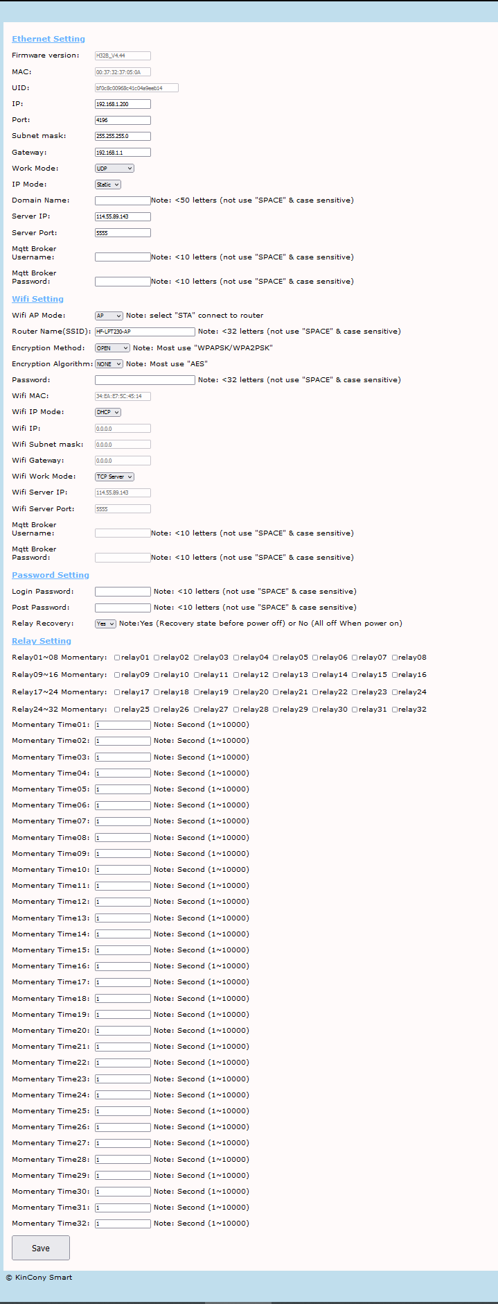

1. take a screen photo of your network setting webpage.
2. after added, you should go to "mine" - "device" - "Unclassified" , set a ROOM for controller. (08-03-2022, 03:25 AM)admin Wrote: 1. take a screen photo of your network setting webpage. Thanks. 1, I attached a photo 2, https://www.youtube.com/watch?v=yIVPCTmbKzg I created Floor and Room settings. -The yellow led lights up on the controller next to the power connector. -The red and blue LEDs light up next to the LAN connector. -I'm using a LAN. I can operate the device from a computer, but not from Android.
08-03-2022, 03:11 PM
I can operate the device from a computer? by which software? or just by webpage?
