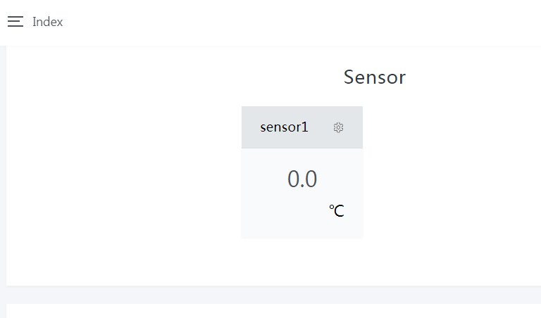

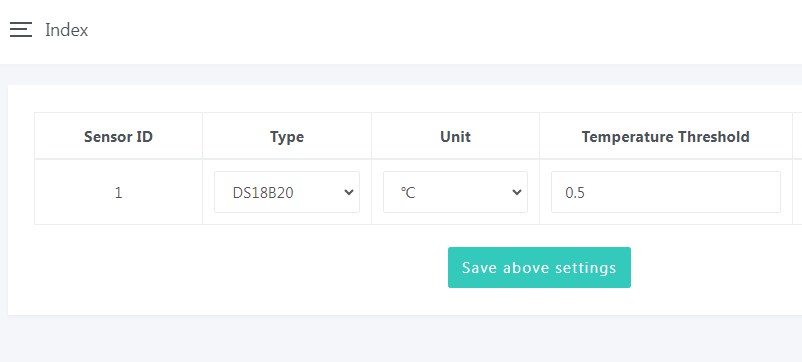

Good afternoon! I ran into the following problem: when connecting a temperature sensor DS18B20, it shows a value from 0 and more. It does not show a negative temperature. What could this be related to? The board is KS868-A4, Software Version v2.1.9. The sensor is now installed outside the window. The temperature outside is "-7" C. The length of the sensor cable is 0.7 m. I have two such sensors and both give the same readings.

(12-07-2023, 01:32 AM)admin Wrote: new firmware fixed this issue, download link: Hello. That's great! Thanks for the new firmware. When connected to a Windows 11 PC, the bootloader displays this message (pic 1). On a Windows 10 PC, there is no such message. But there was a problem when updating. ESP reports the following: I tried to flash the previous version 2.1.9 again. The firmware loaded, but the controller does not create a Wi-Fi access point and is not detected via KinCony-SCAN_Device. I tried to connect via the Arduino IDE, but I also received an error message. What can I do in this situation?
