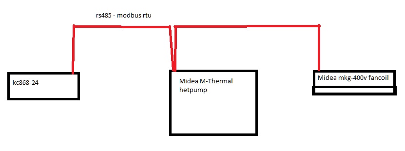

Thanks. But that's not what I asked for. I need a configuration file for exactly this panel. It wasn't cheap and so I can't use it.
In the linked video using 13/16 gpio.
draw a paper, what you want A24 to do and your different devices relationship with A24.
(01-12-2024, 12:23 AM)admin Wrote: draw a paper, what you want A24 to do and your different devices relationship with A24.
I am attaching the requested drawing. Please read older post. Please onen links. It's not a complicated task. I was able to solve it with several tools, as I already wrote. Now I want to solve it with the A24 panel.
The task is already done at home with: https://esphome.io/components/modbus_controller.html (auto flow kontroll)
And with this: https://github.com/Xinyuan-LilyGO/T-CAN485 (flow kontroll pin define is requied)
And with this: http://www.hi-flying.com/elfin-ew10-elfin-ew11
And with this: https://github.com/Mosibi/Midea-heat-pump-ESPHome
But I want to solve it with A24.
Here is my not working esphome config.:
https://pastebin.com/K71z8P50
