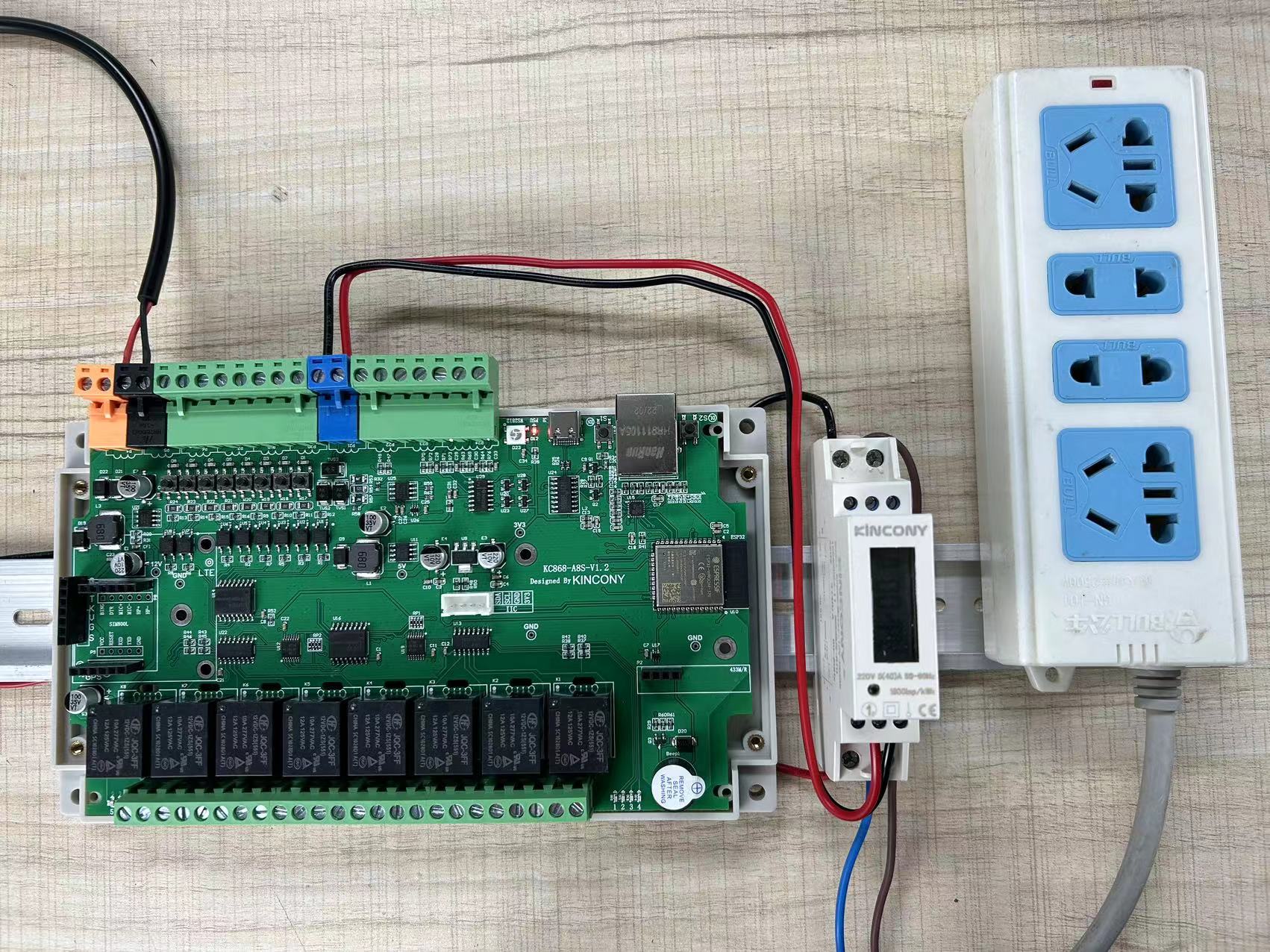

RS485 modbus energy meter integrate to ESPHome yaml file for home assistant
  platform: ESP32
  board: esp32dev
wifi:
  ssid: "KinCony"
  password: "a12345678"
captive_portal:
uart:
  tx_pin: 33
  rx_pin: 32
  baud_rate: 9600
  stop_bits: 1
  parity: EVEN
modbus:
  uart_id: mod_bus
modbus_controller:
  - id: a8s
    address: 0x01
    modbus_id: modbus1
    setup_priority: -10
    update_interval: 5s
sensor:
  - platform: modbus_controller
    modbus_controller_id: a8s
    register_type: holding
    address: 0x64
    unit_of_measurement: "V"
    value_type: FP32
    accuracy_decimals: 2
    address: 0x6A
    unit_of_measurement: "A"
    value_type: FP32
    address: 0x76
    unit_of_measurement: "kW"
    value_type: FP32
    address: 0x8E
    unit_of_measurement: ""
    value_type: FP32
    name: "Grid Frequency"
    address: 0x90
    unit_of_measurement: "hz"
    value_type: FP32
    address: 0x0
    unit_of_measurement: "kWh"
    value_type: FP32
# Enable Home Assistant API
yaml file for KC868-A8S download:
.txt   HA_modbus_energy-meter.txt (Size: 1.91 KB / Downloads: 1,418)
KinCony energy meter RS485 modbus protocol document:
.pdf   KinCony-energy-meter-rs485-modbus-protocol.pdf (Size: 117.75 KB / Downloads: 1,827)
Is it possible to use RS485 on the KC868-A8S to read data according to IEC 62056-21, mod C , 7E1 via ESPHome? It is not Modbus RTU.
Thank you

Hi, trying to set this up  to work in a KC868-Server. I'm having a few issues:
Error:
[09:17:47][D][modbus_controller:043]: Modbus command to device=1 register=0x76 countdown=0 no response received - removed from send queue
[09:17:48][W][modbus_controller:136]: Duplicate modbus command found: type=0x3 address=142 count=4
Config attached: config_modbus.txt
Photo attached of wiring.
Thank you
.txt   config_modbus.txt (Size: 1.84 KB / Downloads: 577)

Tried re-setting the address to 222 (0xDE) but and also inverting tx with rx pins but got the same results ... any help will be much appreciated.
here is my KC868-Server config yaml for KinCony's modbus energy meter:
.txt   KinCony_modbus_meter.txt (Size: 1.43 KB / Downloads: 639)

I had to remove lines including count: 2 for config to work.
Once valid config I don't see values displayed, see attachment please.
After enabling DEBUG for modbus I see:
2024-02-02 14:06:39.383 ERROR (SyncWorker_10) [homeassistant.components.modbus.modbus] Pymodbus: hub1: Error: device: 1 address: 100 -> Modbus Error: [Input/Output] Modbus Error: [Invalid Message] No response received, expected at least 4 bytes (0 received)
2024-02-02 14:07:14.617 DEBUG (SyncWorker_1) [homeassistant.components.modbus.modbus] Pymodbus: hub1: Error: device: 1 address: 106 -> Modbus Error: [Input/Output] No Response received from the remote slave/Unable to decode response
2024-02-02 14:07:49.853 DEBUG (SyncWorker_12) [homeassistant.components.modbus.modbus] Pymodbus: hub1: Error: device: 1 address: 118 -> Modbus Error: [Input/Output] No Response received from the remote slave/Unable to decode response
2024-02-02 14:08:25.093 DEBUG (SyncWorker_11) [homeassistant.components.modbus.modbus] Pymodbus: hub1: Error: device: 1 address: 142 -> Modbus Error: [Input/Output] No Response received from the remote slave/Unable to decode response
2024-02-02 14:09:00.336 DEBUG (SyncWorker_6) [homeassistant.components.modbus.modbus] Pymodbus: hub1: Error: device: 1 address: 144 -> Modbus Error: [Input/Output] No Response received from the remote slave/Unable to decode response
2024-02-02 14:09:35.573 DEBUG (SyncWorker_10) [homeassistant.components.modbus.modbus] Pymodbus: hub1: Error: device: 1 address: 0 -> Modbus Error: [Input/Output] No Response received from the remote slave/Unable to decode response
2024-02-02 14:10:10.813 DEBUG (SyncWorker_12) [homeassistant.components.modbus.modbus] Pymodbus: hub1: Error: device: 1 address: 100 -> Modbus Error: [Input/Output] No Response received from the remote slave/Unable to decode response
