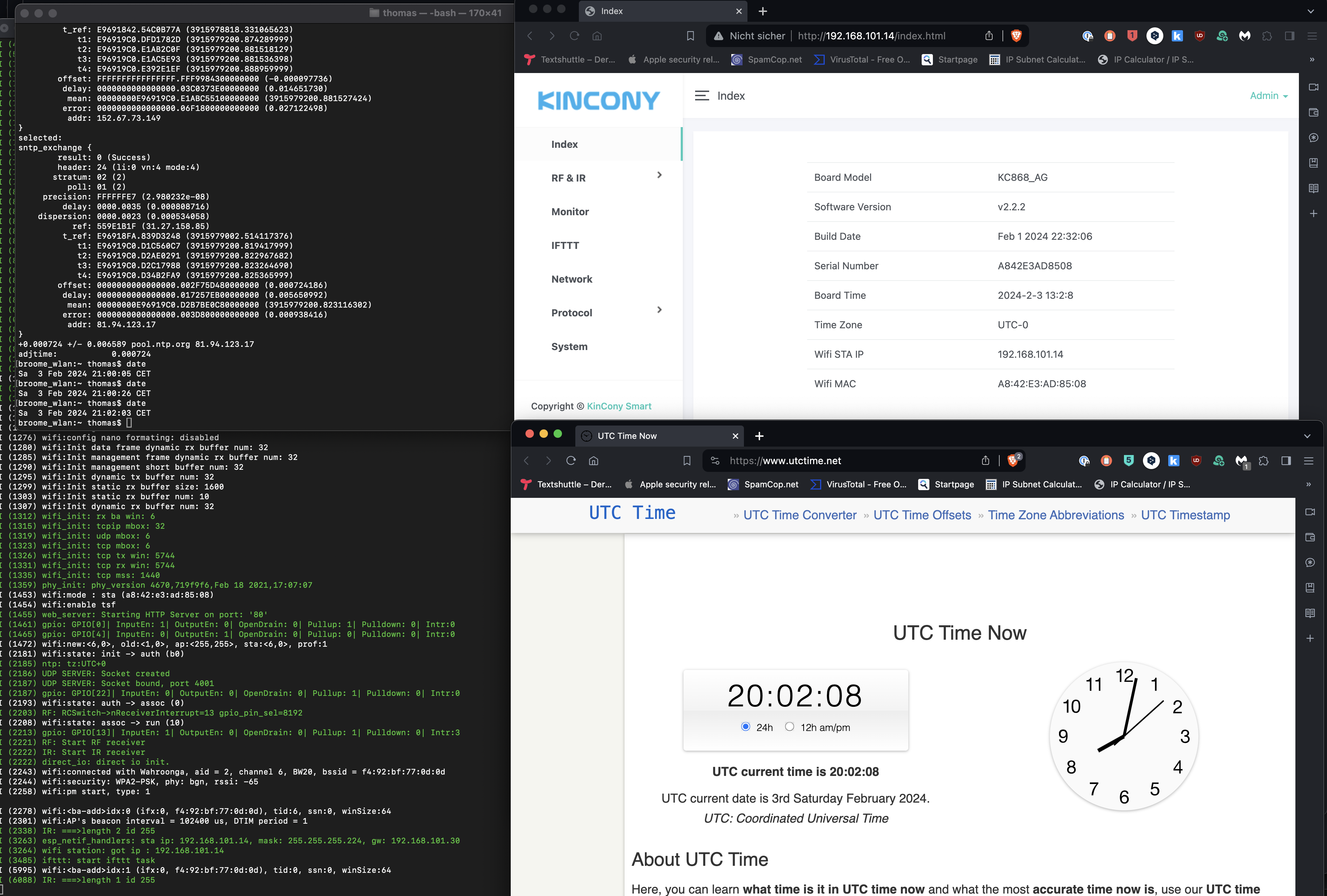

(01-28-2024, 04:47 PM)thotha Wrote: As a proof that the device is getting NTP time code, see this video.
Also you will see, that if I change the time zone to UTC+8 which is the one you are living, even then it's wrong.
It also does proof that you have probably a code failure where UTC+0 is instead shwon as UTC+7.

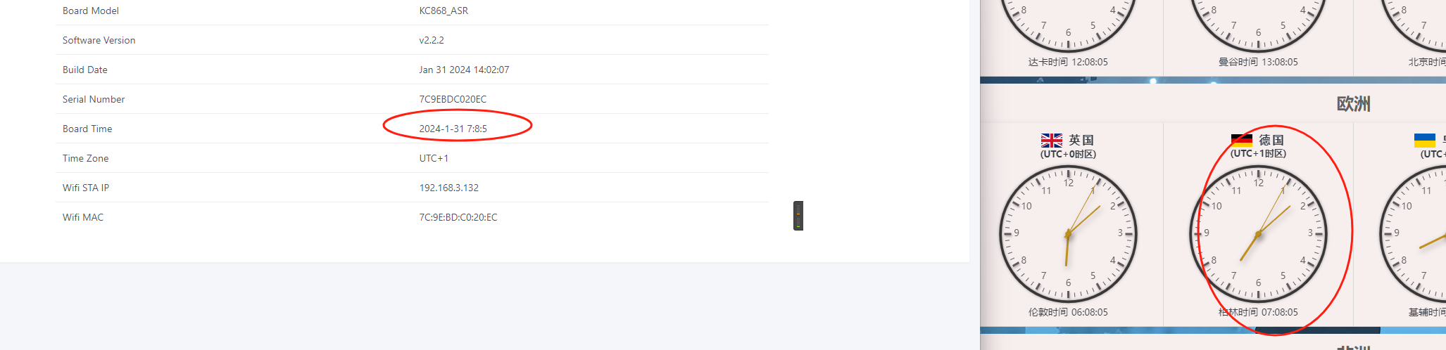

we have tested with UTC+1 , it seems correct. when need have a option for "summer time" or "winter time" ?

we have re created V2.2.2 for KC868-AG firmware, you can test it.
here is BIN file download
.zip   KCS_KC868_AG_V2.2.2.zip (Size: 725.5 KB / Downloads: 805)
here is we tested with AG V2.2.2 firmware by UTC+1 time zone.

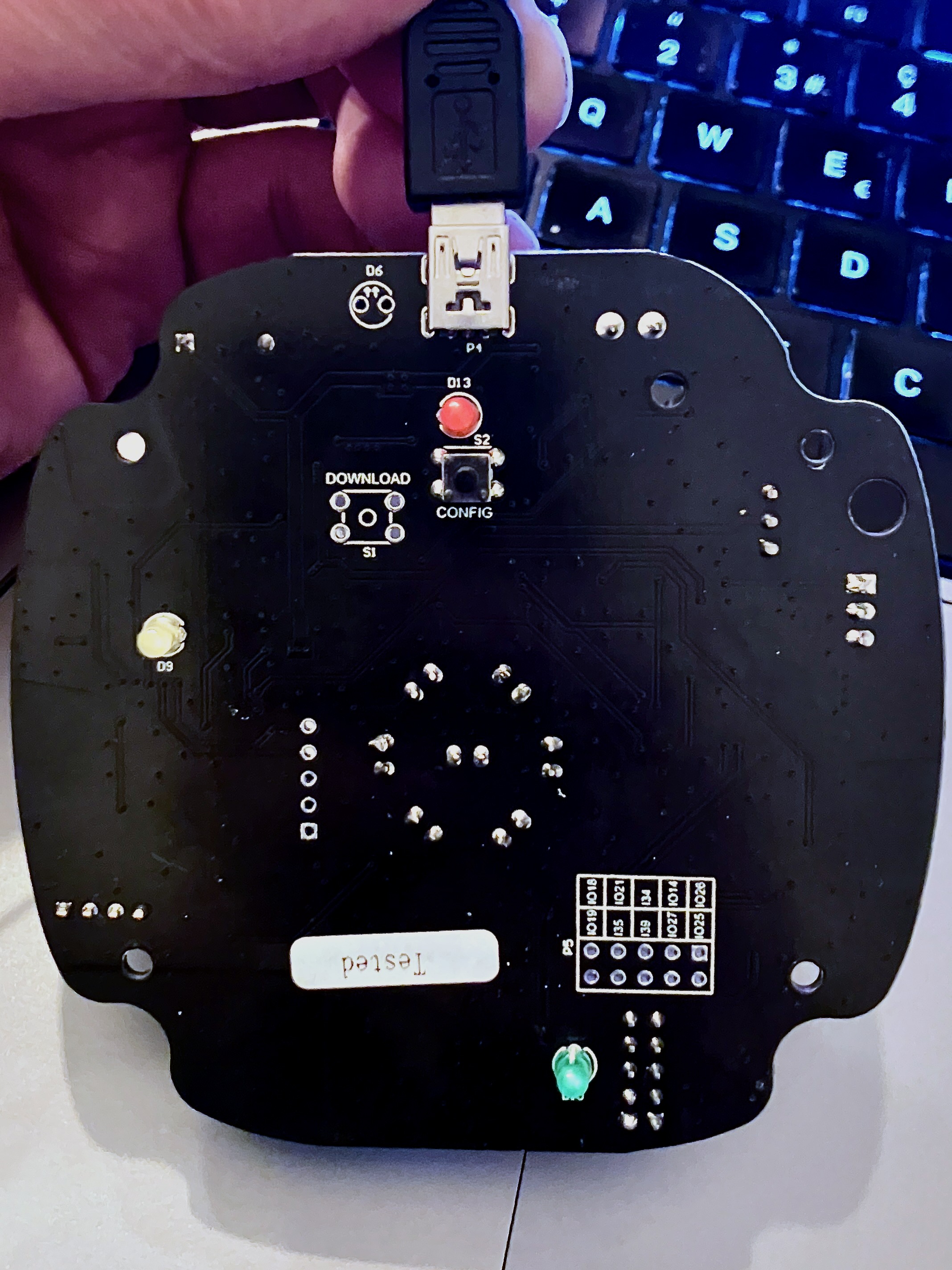

hold on the "DOWNLOAD" button (GPIO0) >10 second , RESET for board. then test again. if also have problem, let your PC conenct to USB port, open serial debug tool (Baud rate: 115200bps), it will feedback LOG, post you LOG at here, we check.
#29
(02-03-2024, 12:50 AM)admin Wrote: hold on the "DOWNLOAD" button (GPIO0) >10 second , RESET for board. then test again. if also have problem, let your PC conenct to USB port, open serial debug tool (Baud rate: 115200bps), it will feedback LOG, post you LOG at here, we check.
There is no such button. The only one is "CONFIG" written on the PCB or "Reset" on the buttom case.

Attached I'll send you:
- log export form serial connection to your device - KCS-868-AG-Pro.txt
(As a side NOTE: Your device shows up as TWO serial devices. usbserial-110 and wchusbserial110!)
- log export for testing assess to pool.ntp.org and actual time - sntp time server test.txt

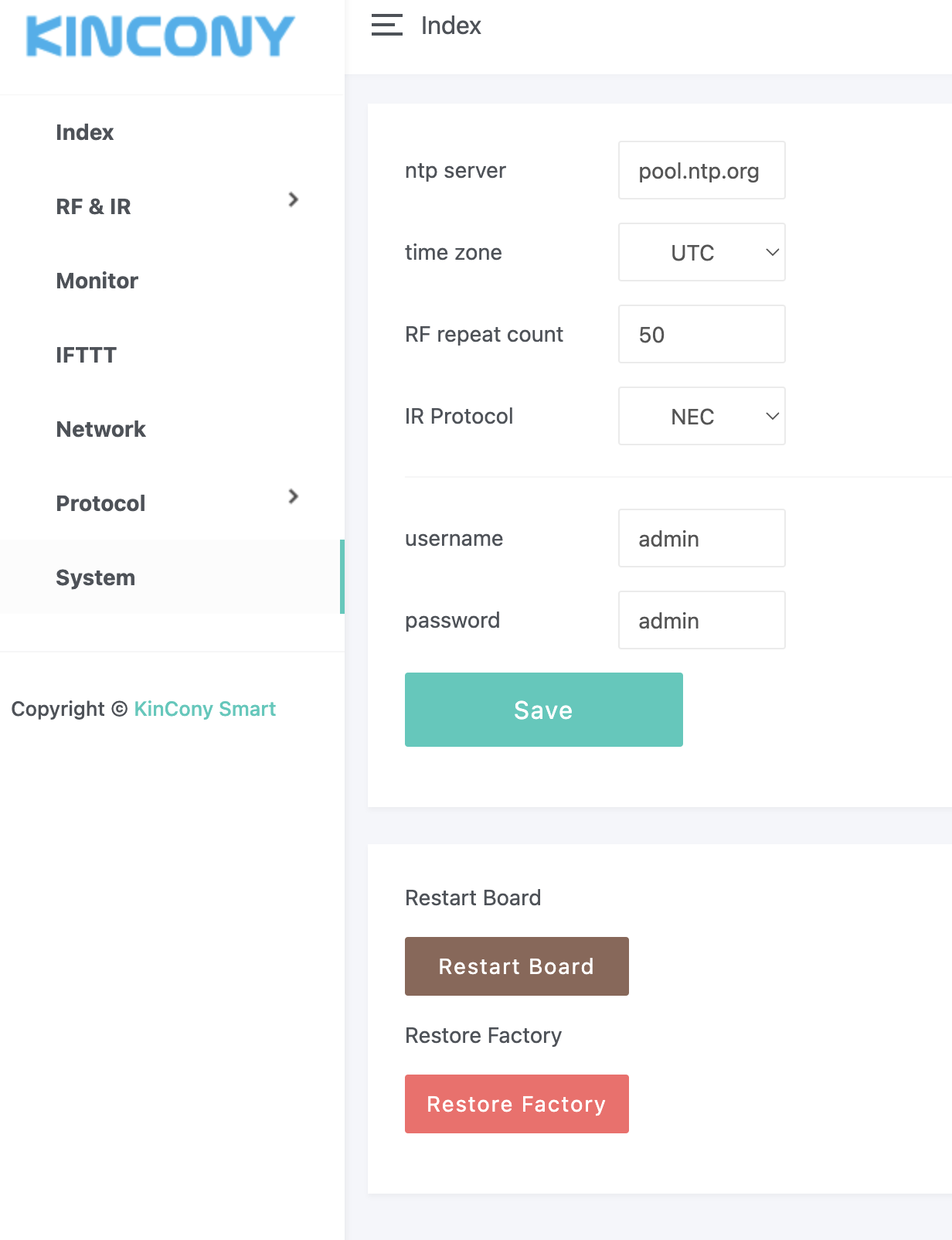

- picture where you can see actual UTC time, UTC time shown on your device, time shown in terminal - KCS-868-AG-Pro.png
- picture showing that pool.ntp.org is set in your device - KCS-868-AG-Pro-NTP.png
For me it seams that some where in your programming you do deduct 7hours form the time your divce is getting form pool.ntp.org.

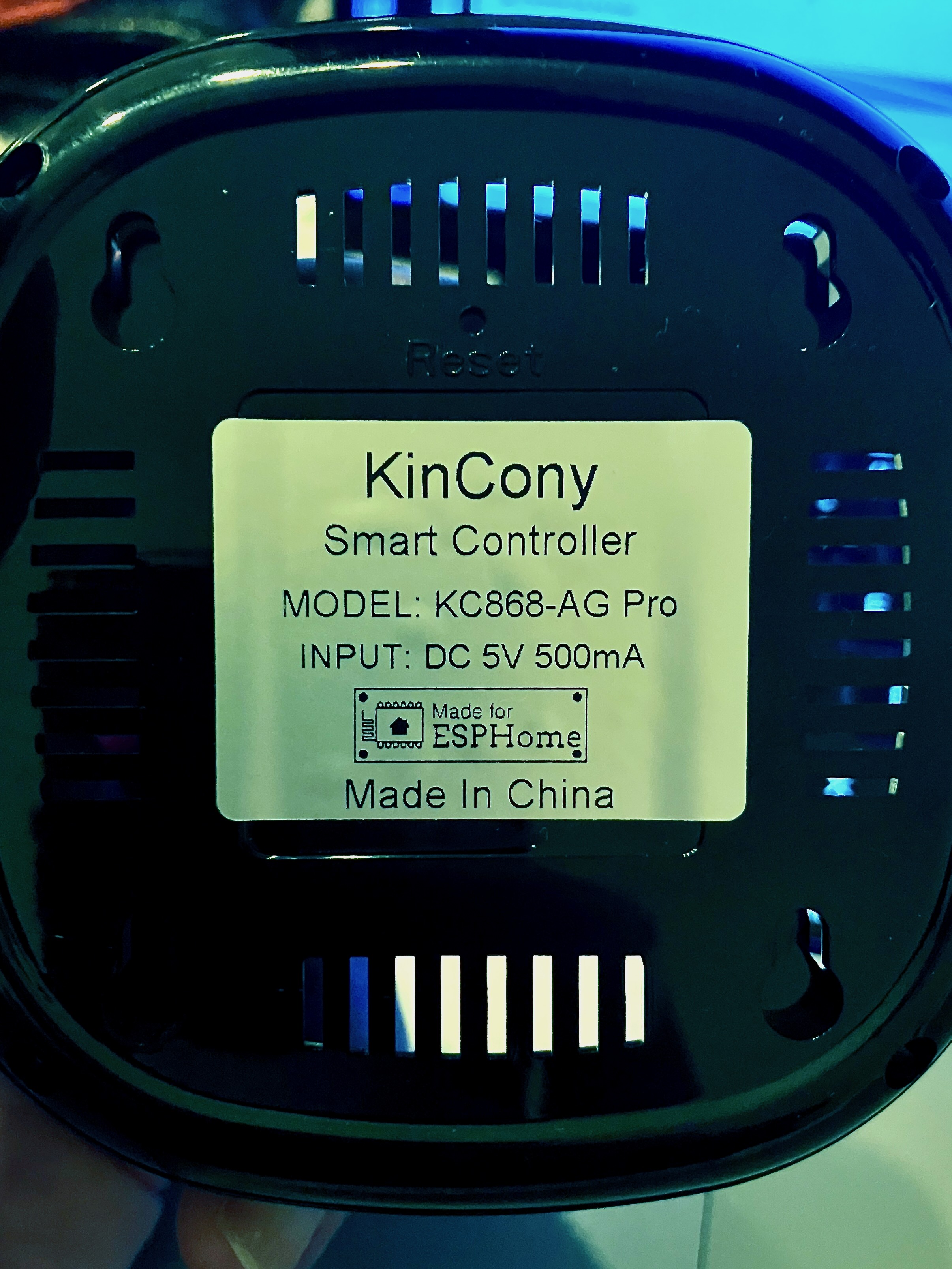

And here some pictures form the PCB of my unit in trouble.
