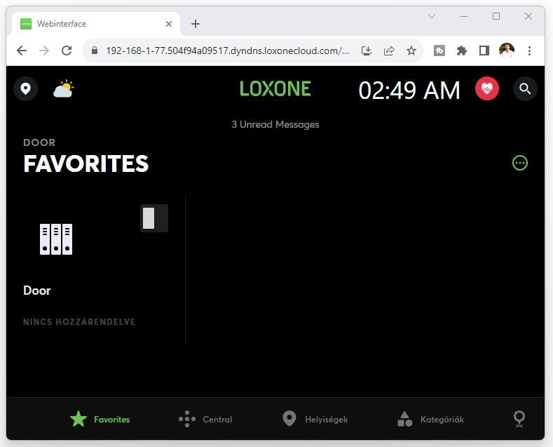

how to integrate smart door lock to Loxone miniserver by cloud server API
1. make sure you can use your mobile phone app remote control your door lock.
2. Door lock supplier website registration developer account
3. after "approved" your developer account, will get a "client_id“,”client_secret"
4. Get access token
5. unlock door
integrate to Loxone miniserver:
Loxone config project file:
.zip   Door.zip (Size: 15.76 KB / Downloads: 1,133)
.zip   door.c.zip (Size: 854 bytes / Downloads: 1,077)
.pdf   LoxoneDoor.pdf (Size: 171.81 KB / Downloads: 1,605)
