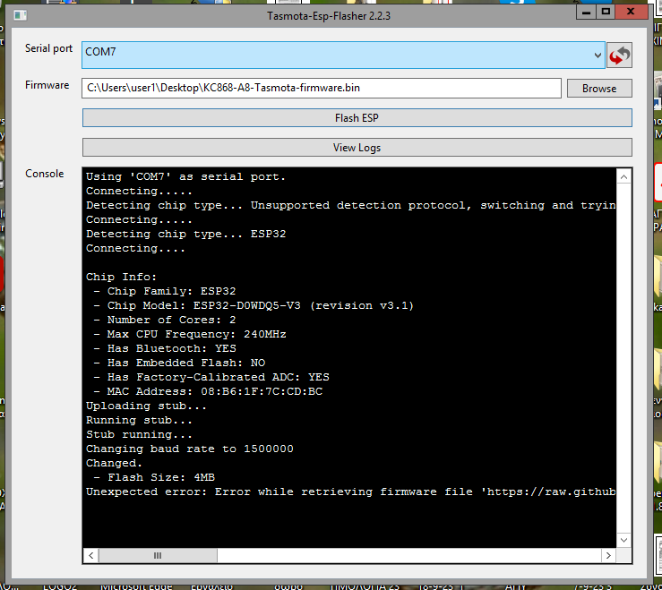

take a photo of your screen. which download software you are using?
(02-16-2024, 11:12 PM)admin Wrote: take a photo of your screen. which download software you are using?
here is it, the software is called ESP-flasher.
