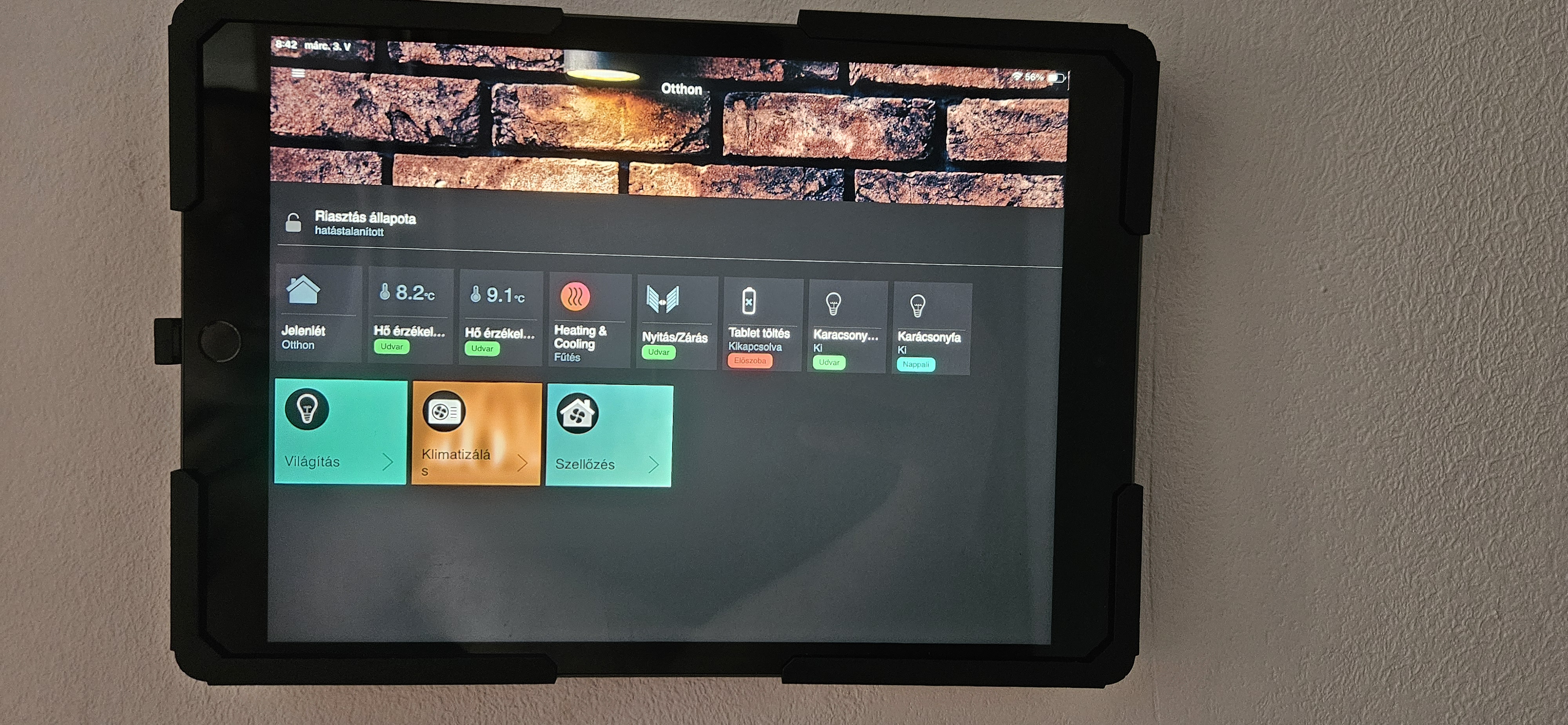

In my house I integrated the KC868 A4, A8 and A16 controllers (with KCS firmware) into the TapHome system. I used the Http Server for the connection. The static ip address is important here.
In the case of A8 and A16, the static ip can be set in the KCS, but in the A4 it is not available, as it only has wifi.
Is there a possibility for this? I ask for your help.
Regards, Zoltán
