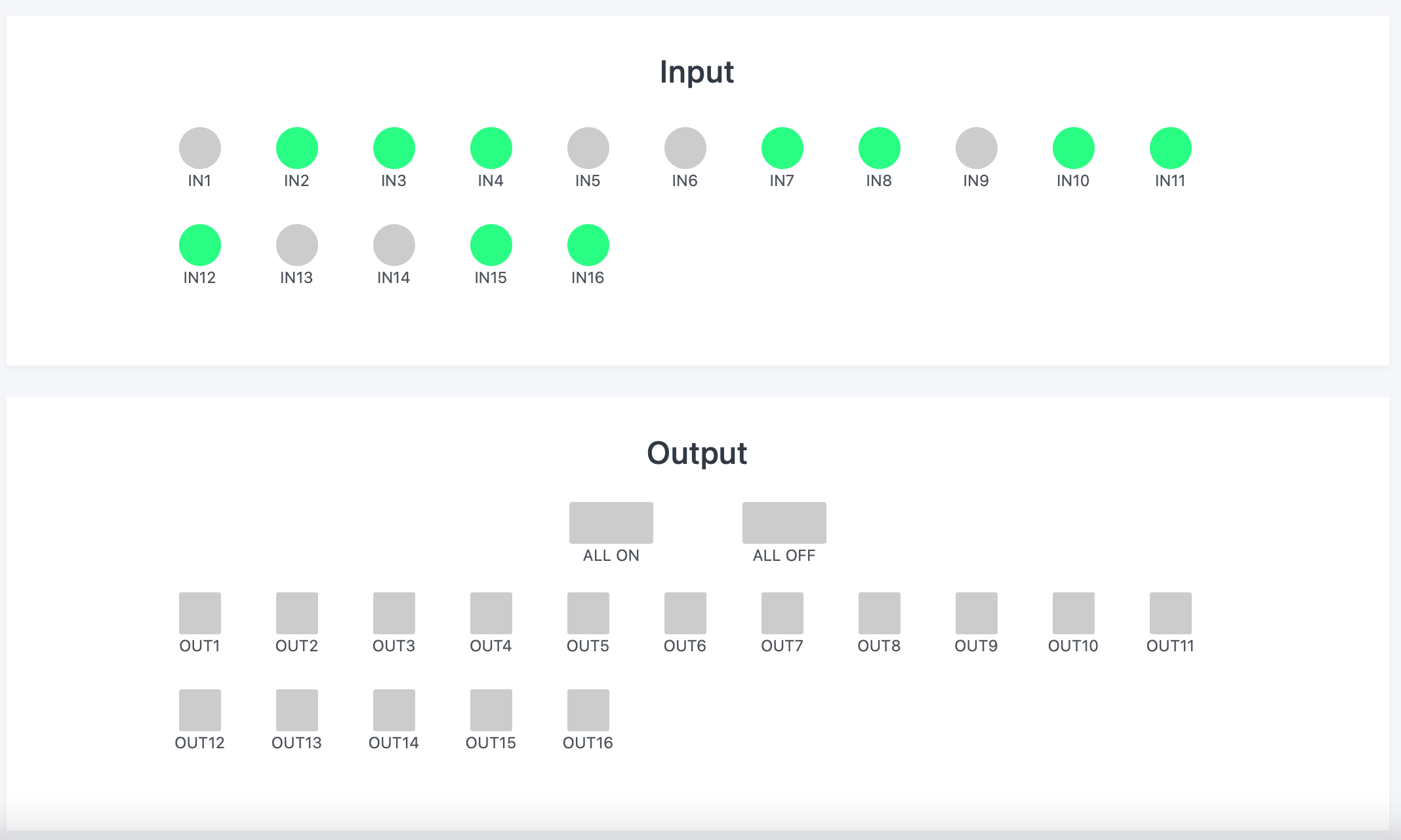

Dear team,
the KCS 2.2.2 is not working for me.
- DI are at random and not changing when making a connection with GND.
- DO can't be switched either.
- Note this is only with the KCS firmware, my own code works fine.
- Maybe it is to be noted that the I2C addresses do not match the standard for my board, as stated here: https://www.kincony.com/forum/showthread...67#pid6767
Please advise.

The outputs are working now with the modified version, but the inputs (all shown OFF) are not recognized.
With my code in contrast everything works (but I want to use KCS!):
