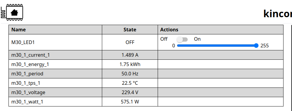

Hello, in your video you are measuring 240V and 0.21A, which equals 50.4W. But in the video, it shows 32.3W. I have the same issue; the voltage and current are measured correctly, but the power and energy are not measured accurately. Is there any way to calibrate it to measure correctly?
M30 does not correctly read power and energy
03-04-2024, 12:15 AM
dashboard showed the "actual power value" read from BL0910 chip register. Each electrical appliance has different power factors, so the actual value may differ from the theoretical value.

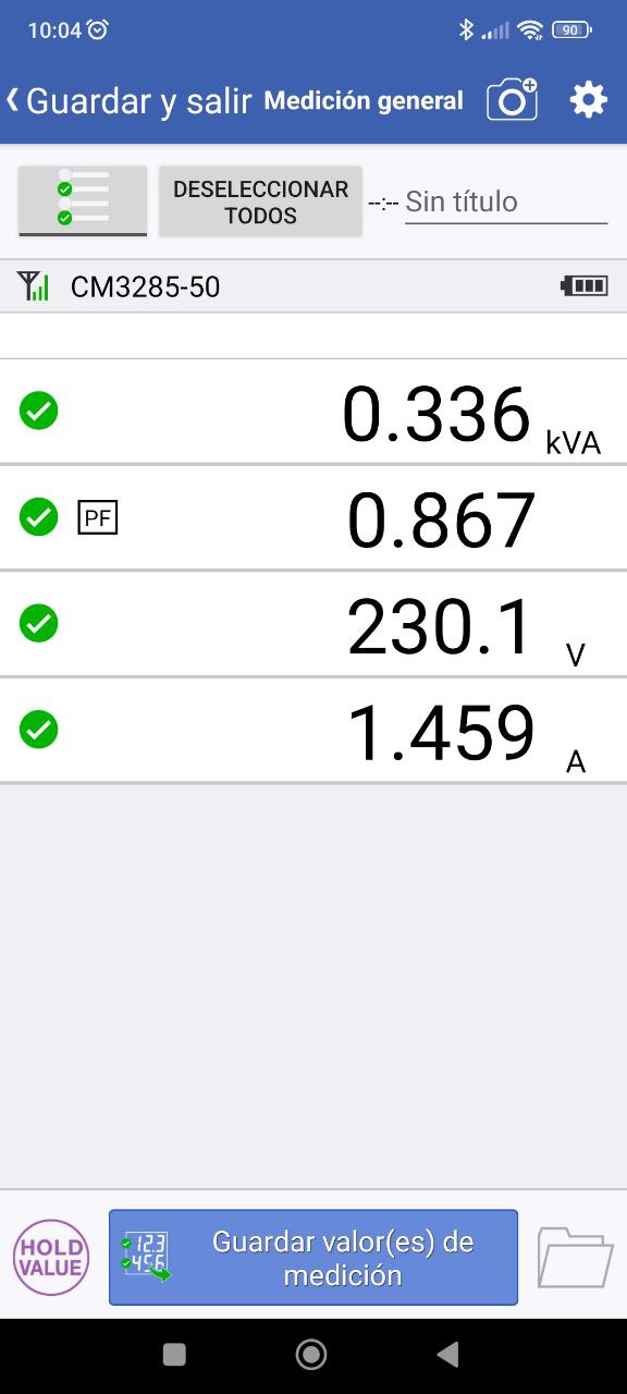

Good morning, but I have a professional Hioki CM3285-50 power clamp meter that reads power factor, and it differs significantly from the values on the M30.
we will check it.
03-05-2024, 06:36 AM
can you give me more data, such as your monitor image.
now your photo is 1.462A load. can you test with more different current. such as 2.xxx A or 3.xxxA or others. give me more "Hioki CM3285-50 power clamp meter" detected image. then we will update the "power factor", make a new M30 firmware send to you.
