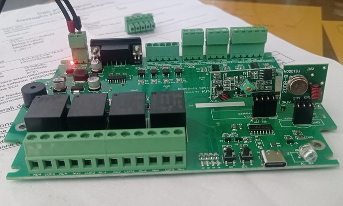

KC868A-4 RF433MHz decoding.
If I understood the meaning of the sample code. Once uploaded the code, opening the Serial monitoring to Arduino IDE I should see the code transmitted  from 433 MHz remote control.  I don't understand why to the monitor I don't see anything. I'm sure that the remote control and receiver module woks fine because to the receiver data pin, with a scope ,when I press one button to the remote control, I see the pulse train.

With my oscilloscope, I made picture. The down CH, is what I'm sending (P4,Pin3). The upper CH is The out from U8, pin4 (RX Amplifier) That is connected straight to esp32 pin 31 (IO19).
As we can see from pictures There is not any output to the seial monitor.
Any suggestion to solve this issue ?

As do you can see on the oscilloscope picture trasmitted signal and received signal are in the same fase. Anyway  with the code below (I enabled only the receiver) pressing one button to the remote control,  On U8 Pin 4 (strigth connected  with IO19)  We can see received signal very cleaned (see picture in attacment.) But there is not output to the serial monitor.

The above code is  the arduino receiver demo code . At the power on print "begin test" Then if I press the remote butto doesn't print anything :I made test with some differentes remote control, nothing appen. It look like the ESP32 doesn't read the IO19. I suspect it defective
A4 RF433M receiver pin is IO13, here is code:
