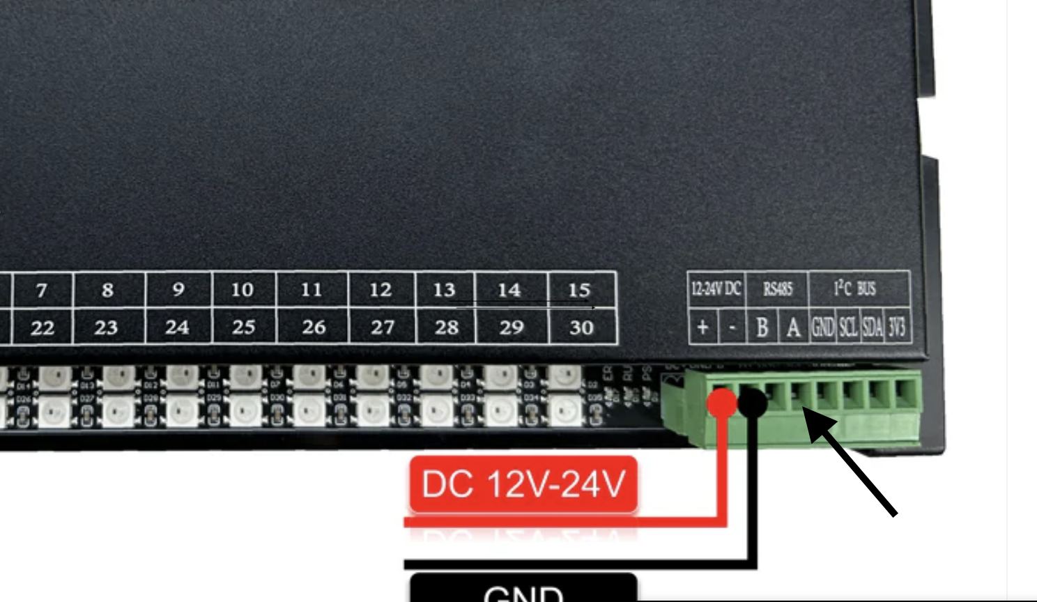

(07-11-2024, 11:11 AM)admin Wrote: M30 RS485 port not connected with ESP32's gpio. it's just a MODBUS SLAVE device. if you MUST want use by ESPHome, connect this RS485 wire with other KinCony ESP32 board's RS485 port.
Ohh!great so I can use with the A24 pro for example? in The oficial yaml file for the a24 and the a32 pro there is no info for the rs485.. Can you share how to use the RS485 with the a24? Thanks a lot!!
