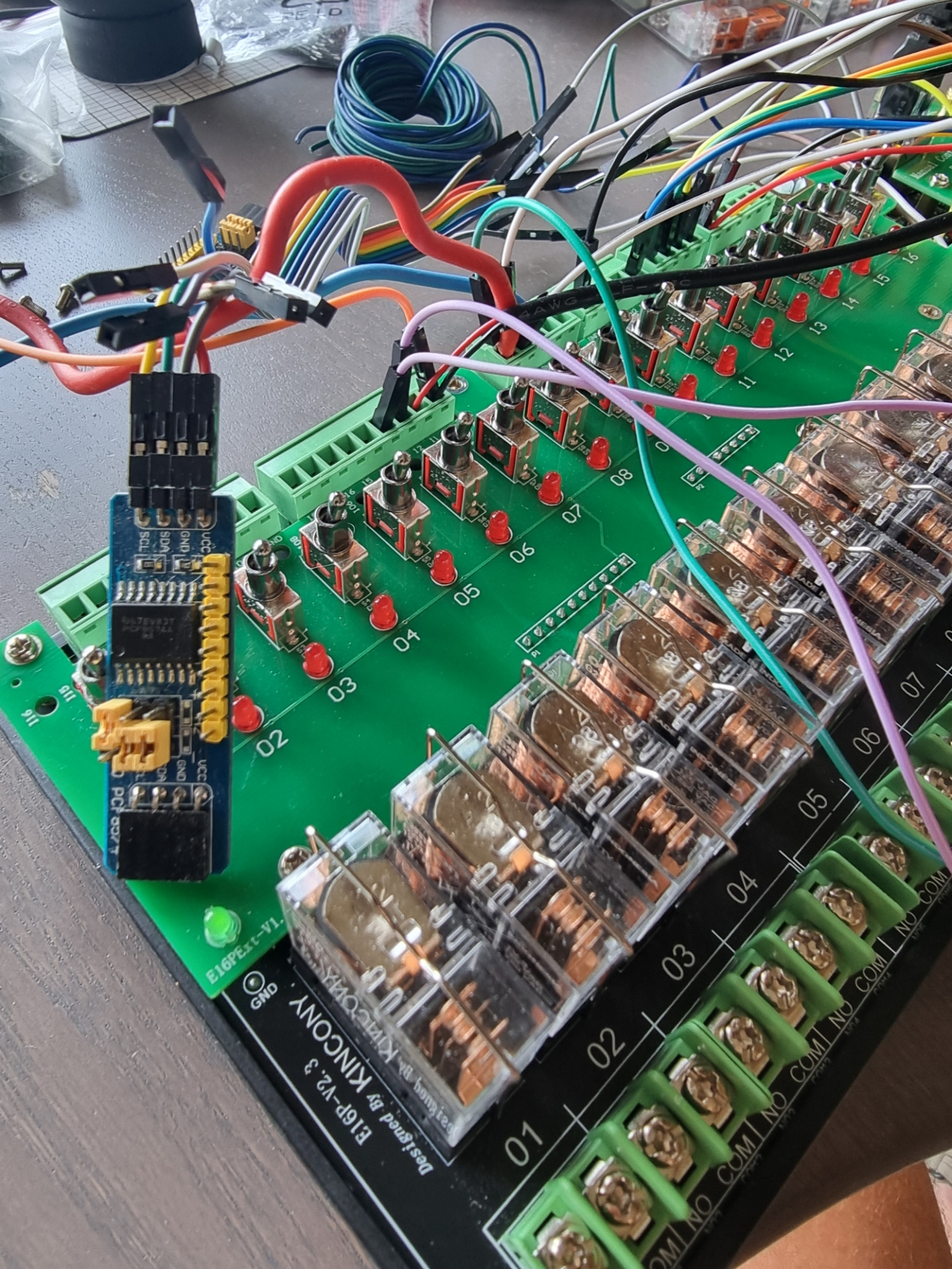

- Results from i2c bus scan doesn't detect the EZO sensor (I know the SDA / SCL ports are OK since I am able to detect an additional PCF8574 board for instance).
- While the device isn't detected, it is somehow interfering with ESP32 since I am seeing this in the logs:

Thanks but it didn't help I am afraid.
My 2 i2c sensors work between 3 to 5v DC so they should have been detected by i2c scan.
Neither are working properly (but I can see that they are under power - green light on).
If I swap them by a PCF8574, this one is detected in the logs and works well.
See attached photos & logs for more clarity.
