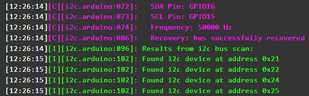

- Results from i2c bus scan doesn't detect the EZO sensor (I know the SDA / SCL ports are OK since I am able to detect an additional PCF8574 board for instance).
- While the device isn't detected, it is somehow interfering with ESP32 since I am seeing this in the logs:
                [W] [component: 157]: Component pcf8574 set Warning flag: unspecified
                [W] [component: 170]: Component pcf8574 cleared Warning flag

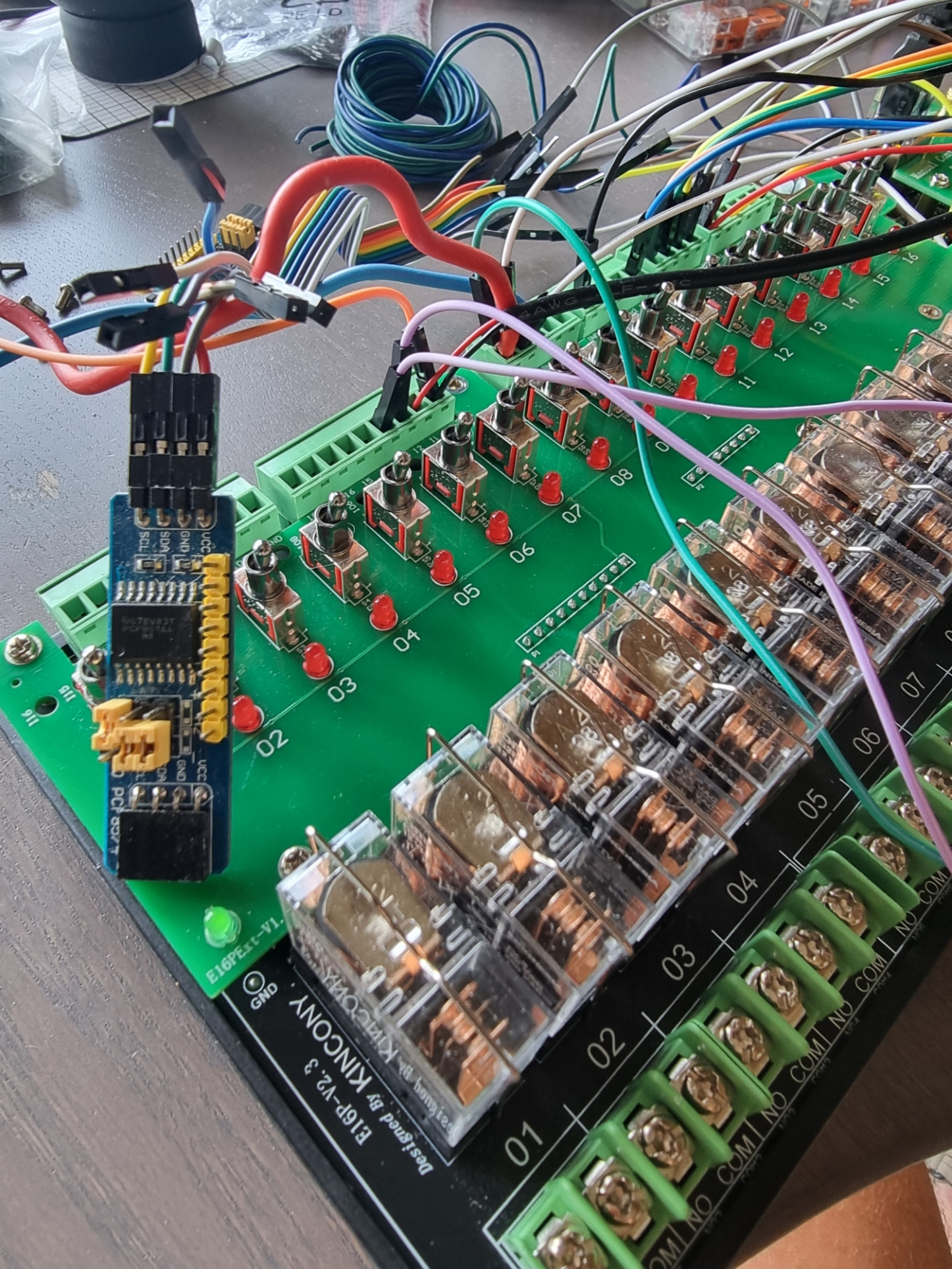

- For my second  EZO sensor, should I connect it to the IC2 extender ?
Thank you.
if the sensor is i2c bus, you can connect with i2c extender. VCC,GND,SDA,SCL.
(07-13-2024, 01:40 PM)admin Wrote: if the sensor is i2c bus, you can connect with i2c extender. VCC,GND,SDA,SCL.
Thank you for your fast answer.
I cannot test i2c extender yet since I need to order the connector.
Could you clarify please:
i2c SDA on GPIO16 and i2c SCL on GPIO15 cannot be used right ?
use this i2c pin define in ESPHome:
IIC SDA:GPIO16
IIC SCL:GPIO15
connect your sensor's 4 pins with i2c extender, just need confirm your sensor's i2c interface power voltage. suggest you take a photo of your sensor interface.

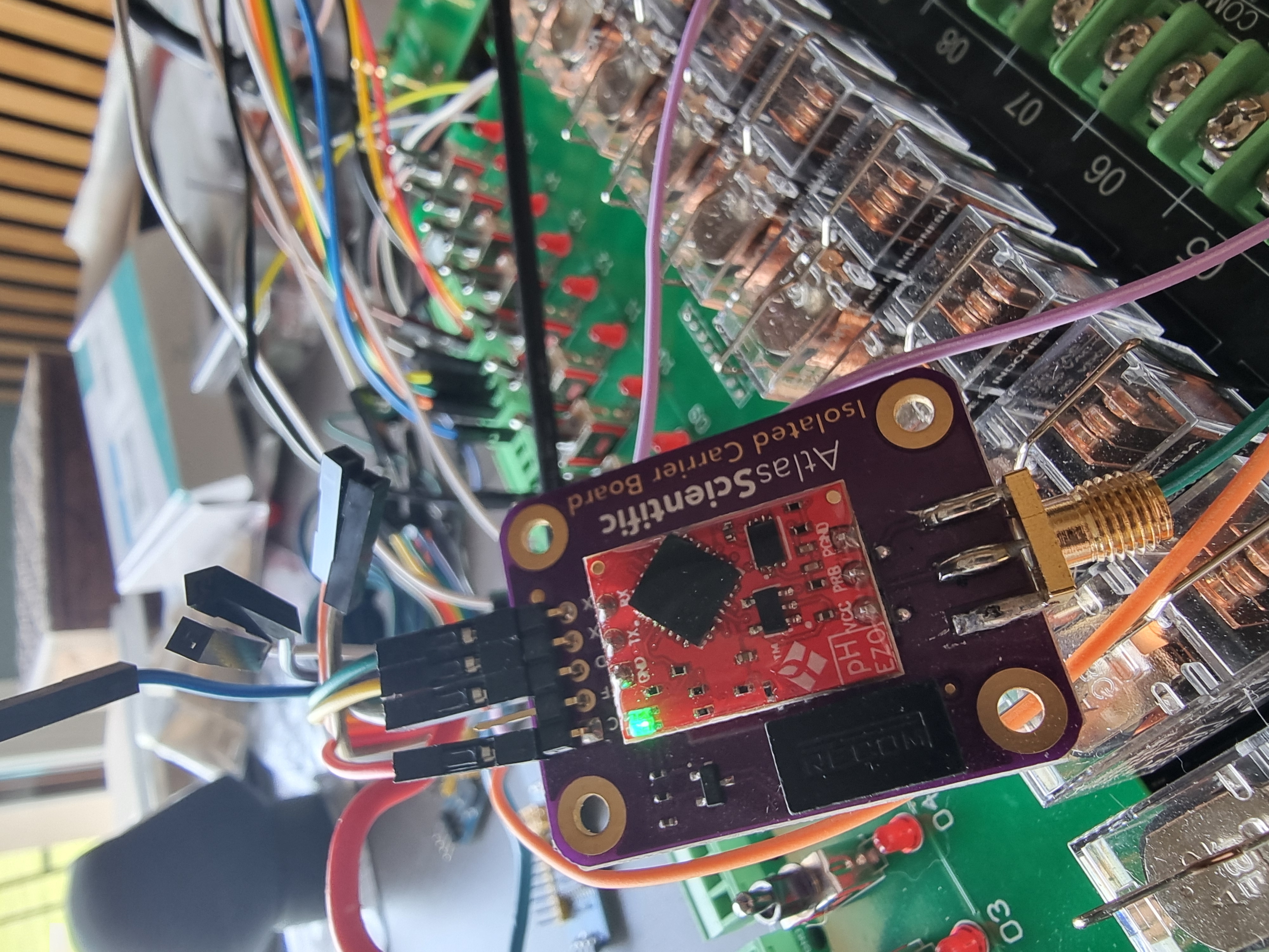

Thanks but it didn't help I am afraid.
My 2 i2c sensors work between 3 to 5v DC so they should have been detected by i2c scan.
Neither are working properly (but I can see that they are under power - green light on).
If I swap them by a PCF8574, this one is detected in the logs and works well.
See attached photos & logs for more clarity.

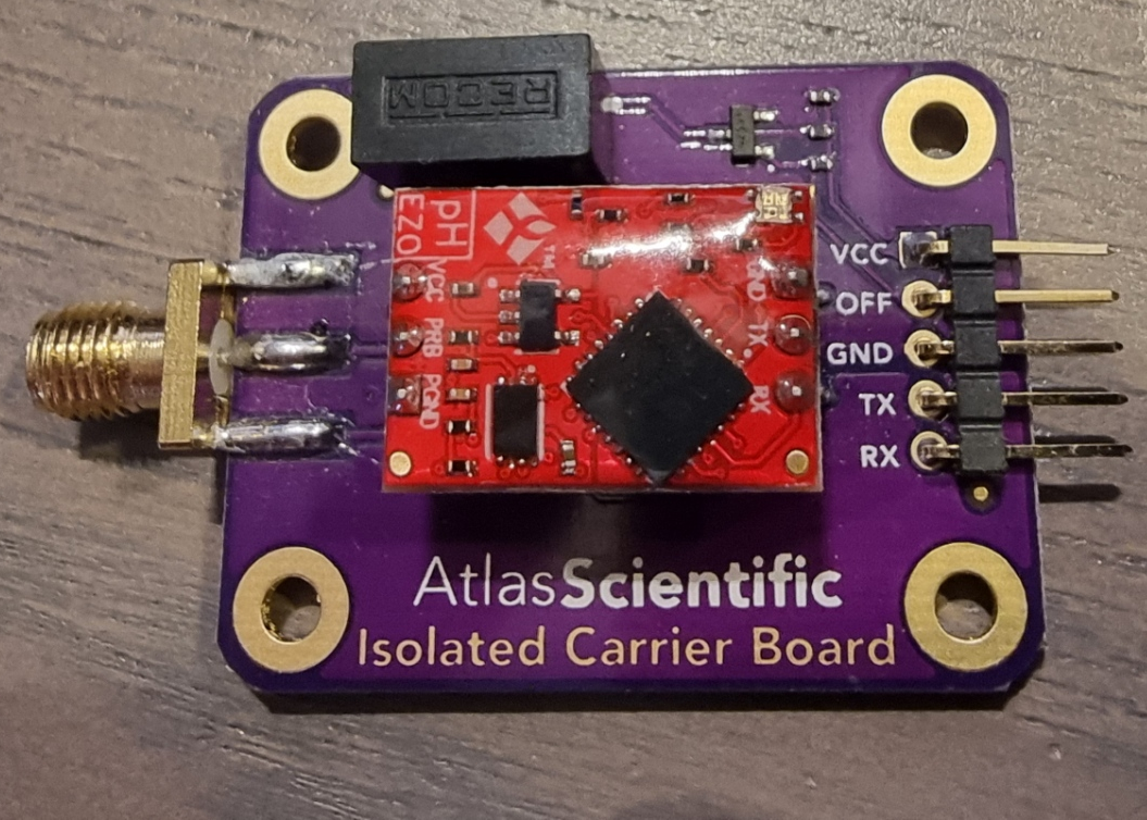

take a photo of your sensor every pin define, now can't see the label on pcb.
(07-14-2024, 12:35 PM)admin Wrote: take a photo of your sensor every pin define, now can't see the label on pcb.
There you are. I am connecting everything except the "OFF" PIN.
TX on SCL
RX on SDA
I also tried inverting them without luck.
As per this link:  Electrically Isolated EZO™ Carrier Board | Atlas Scientific (atlas-scientific.com) both UART or i2C can be used.
There you are.
SCL = TX
SDA = RX
Also tried inverting them just in case.
As per  Electrically Isolated EZO™ Carrier Board | Atlas Scientific (atlas-scientific.com) it should  work with both UART and I2C.
i see now. this is not a i2c sensor, just a serial port sensor. so you can't connect with i2c extender.
the sensor have private protocol, so you can't integrate to home assistant directly.
