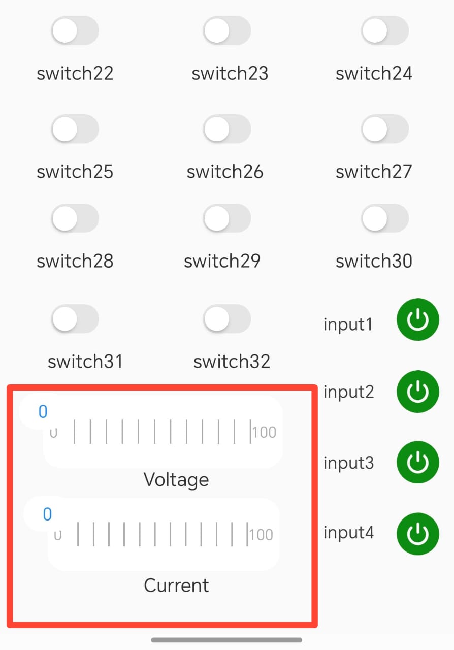

Posts: 10,357
Threads: 1,531
256
hold on the TEXT of "Voltage" and "Current". you can rename by yourself.
