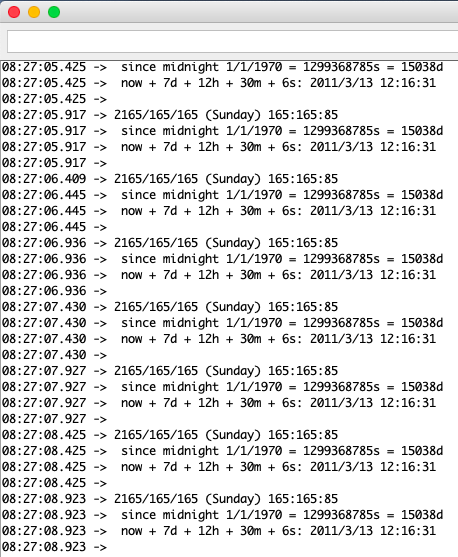

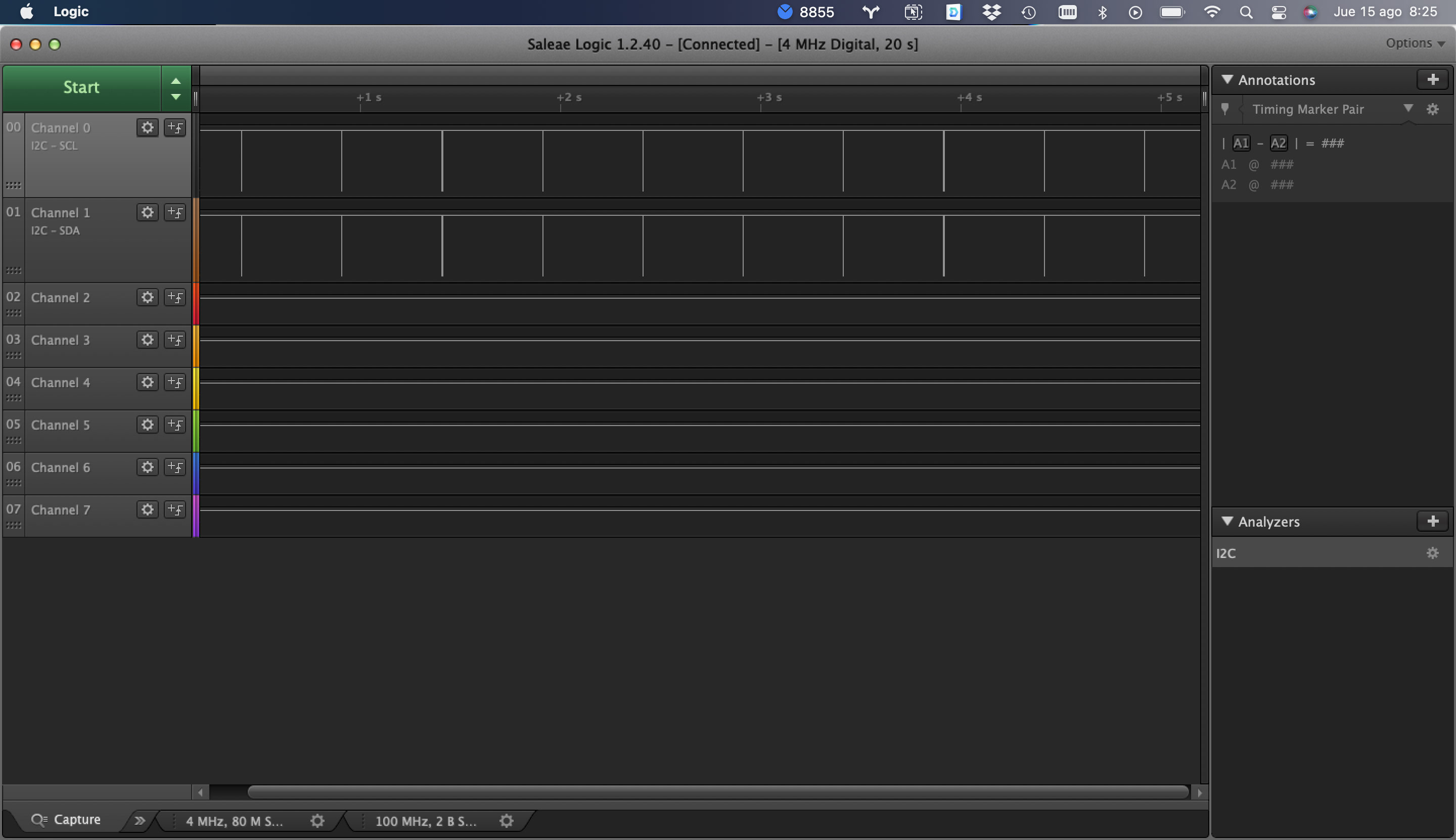

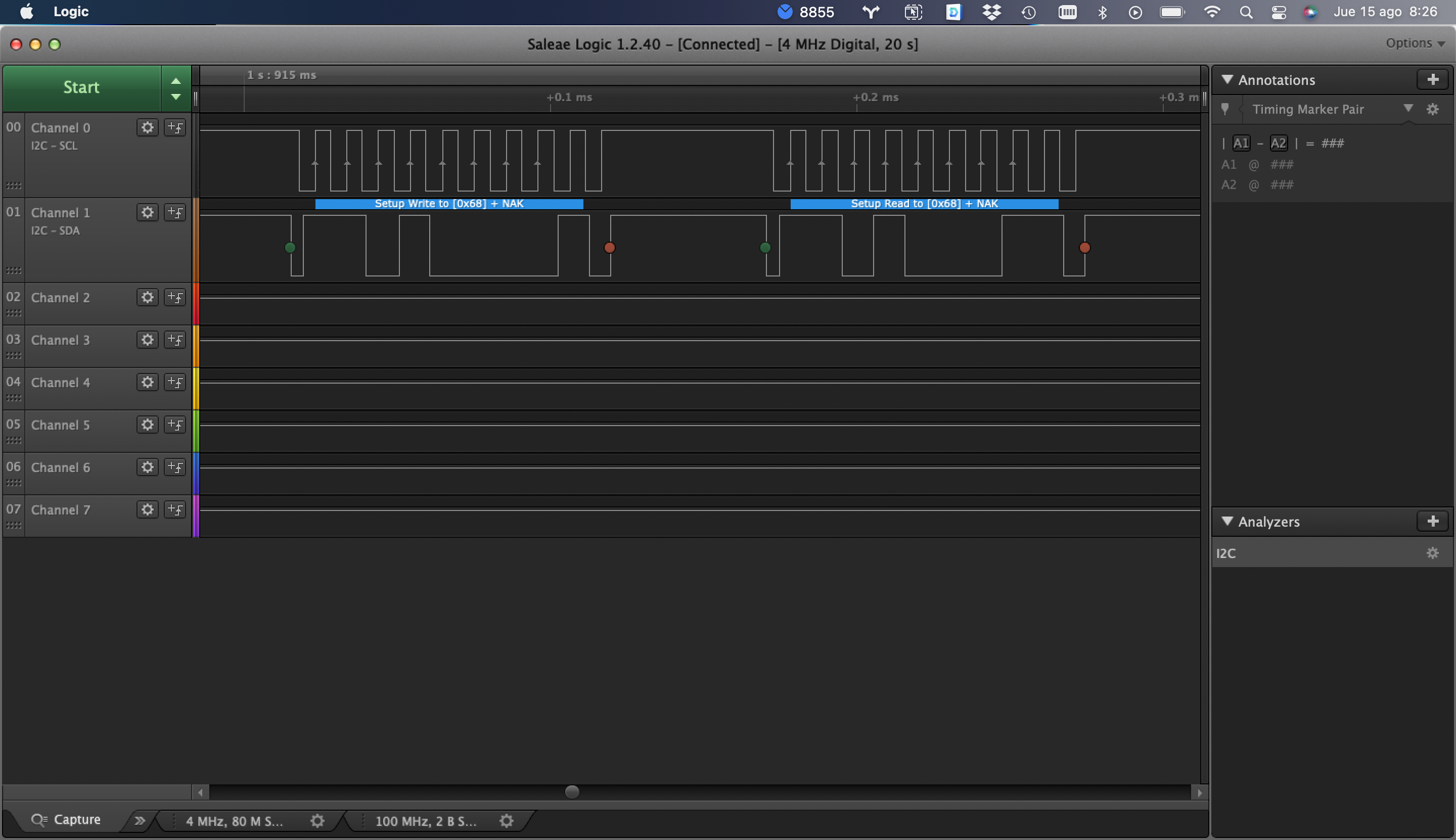

I already found "pins_arduino.h" and modified it. Since then I see activity on the I2C with your test program. However, the result is an endless repeating telegram that doesn't receive any Time as answer. Please see the analyzer pictures. Furthermore the monitor on Arduino IDE is showing the "RTC is NOT running, let's set the time!" message while booting and the returned data which doesn't reflect the activity seen in the analyzer is always the same as per the attached picture.

But i seen your last photo, the LOG already have read the DS1307 time successfully.

However, the photo you mention is showing always the same time. Furthermore the analyzer picture shows that only 1 byte of data are readed on every request.
