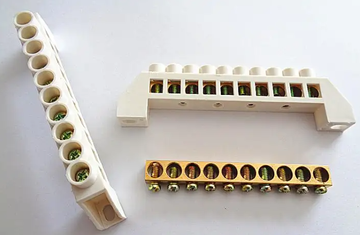

In case of 25A contactor is clear but what about neutral wiring for E16v2 module?
use this one, connect all N together.
