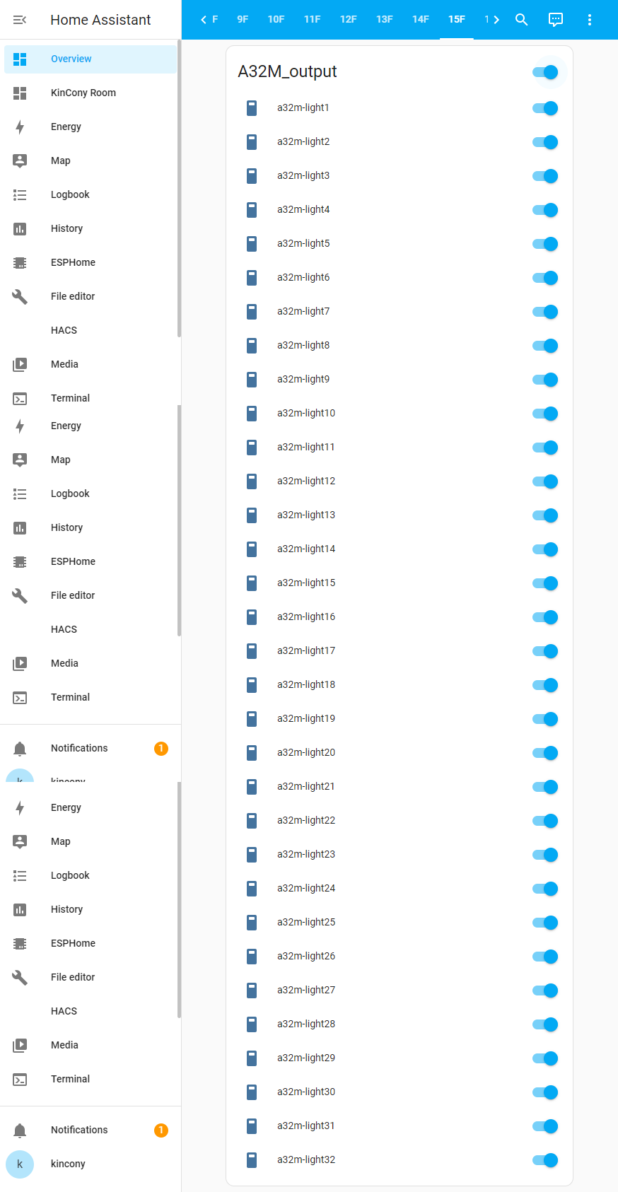

KC868-A32M configure yaml for ESPhome
.txt   HA_A32M.txt (Size: 6.07 KB / Downloads: 801)

Should this config work for kc868-a32 as well? I've copy/pasted the below (and added manual IP address) but nothing is happening (no click)
I've just noticed I was sent Rev 1.2 instead 1.3  - Would that be a problem??
I think this is the interesting part:
[08:55:45][C][pcf8574:021]: PCF8574:
[08:55:45][C][pcf8574:022]:  Address: 0x21
[08:55:45][C][pcf8574:023]:  Is PCF8575: NO
[08:55:45][C][pcf8574:022]:  Address: 0x22
[08:55:45][C][pcf8574:022]:  Address: 0x25
[08:55:45][C][pcf8574:022]:  Address: 0x26
[08:55:45][E][pcf8574:025]: Communication with PCF8574 failed
.txt   logs_kc868-a32_logs.txt (Size: 8.26 KB / Downloads: 635)
this for A32M, if you want to use for A32, here is link:
https://www.kincony.com/forum/showthread.php?tid=1772
Nice! Thank you!
