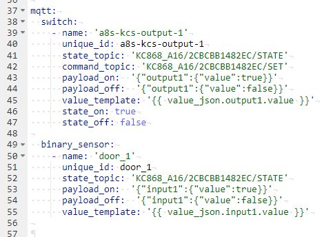

I did everything according to your example. (switch:-output 1) works fine. But "input1" is still in the "unknown" status. Please send an example for KC868-A16 and specifically for (binary_sensor: -"input1"). I would appreciate it.
(10-02-2024, 02:25 PM)Ugeo Wrote: I did everything according to your example. (switch:-output 1) works fine. But "input1" is still in the "unknown" status. Please send an example for KC868-A16 and specifically for (binary_sensor: -"input1"). I would appreciate it. Inputs are not working because of these bugs ! There are bugs in MQTT message in version 2.2.5. Reproduced on A8 and also A16. 1. Missing coma after last input and before first output, example: ... "input15":{"value":false},"input16":{"value":false}"output1":{"value":false}, ... 2. Missing coma after last output and before first adc, example: ... "output15":{"value":false},"output16":{"value":true}"adc1":{"value":0}, ... 3. Missing coma after last adc and before first sensor, example: ... "adc4":{"value":0}"sensor1":{"temperature":-100.0,"humity":-100.0}, ... 4. Typo error on sensor humidity name, example: ... sensor1":{"temperature":-100.0,"humity":-100.0}, ... instead of: ... sensor1":{"temperature":-100.0,"humidity":-100.0}, ... MQTT is not working in version 2.2.5 because of these bugs. (10-02-2024, 02:25 PM)Ugeo Wrote: I did everything according to your example. (switch:-output 1) works fine. But "input1" is still in the "unknown" status. Please send an example for KC868-A16 and specifically for (binary_sensor: -"input1"). I would appreciate it. My binary sensor working code: binary_sensor: - name: 'a16-kcs-input-1' unique_id: a16-kcs-input-1 state_topic: 'KC868_A16/D3AF7679AD2B/STATE' value_template: '{{ value_json.input1.value }}' payload_on: true payload_off: false device: identifiers: "kincony_a16_device" name: "Module Kincony A16" model: "KC868-A16" manufacturer: "Kincony" - name: 'a16-kcs-input-2' unique_id: a16-kcs-input-2 state_topic: 'KC868_A16/D3AF7679AD2B/STATE' value_template: '{{ value_json.input2.value }}' payload_on: true payload_off: false device: identifiers: "kincony_a16_device" name: "Module Kincony A16" model: "KC868-A16" manufacturer: "Kincony" Will work for you with updated KCS firmware! not 2.2.5

Today I installed new firmware 2.2.6 (thanks) and now outputs are working fine:
they can be managed from HAOS (also in 2.2.5) and follows status change (fixed with 2.2.6). The problem remain on Inputs, I cannot see any status change and they are always in "unknown" status. I tryied many options, finally I found the working configuration for inputs: mqtt: switch: - name: "a161-kcs-output-1" unique_id: a161-kcs-output-1 state_topic: "KC868_A16/XXXXXXXXX/STATE" command_topic: "KC868_A16/XXXXXXXXX/SET" payload_on: '{"output1":{"value":true}}' payload_off: '{"output1":{"value":false}}' value_template: "{{ value_json.output1.value }}" state_on: true state_off: false binary_sensor: these are wrong: payload_on: '{"input1":{"value":true}}' payload_on: "true" payload_on: true (Incorrect type. Expected "string") this is working for me - name: "a161-kcs-input-2" unique_id: a161-kcs-input-2 state_topic: "KC868_A16/XXXXXXXXX/STATE" value_template: "{{ value_json.input2.value }}" payload_on: "True" payload_off: "False"
10-29-2024, 01:02 AM
ok, thanks share your code. that need use "True" , not use "true". do you using with KC868-A16 board?
