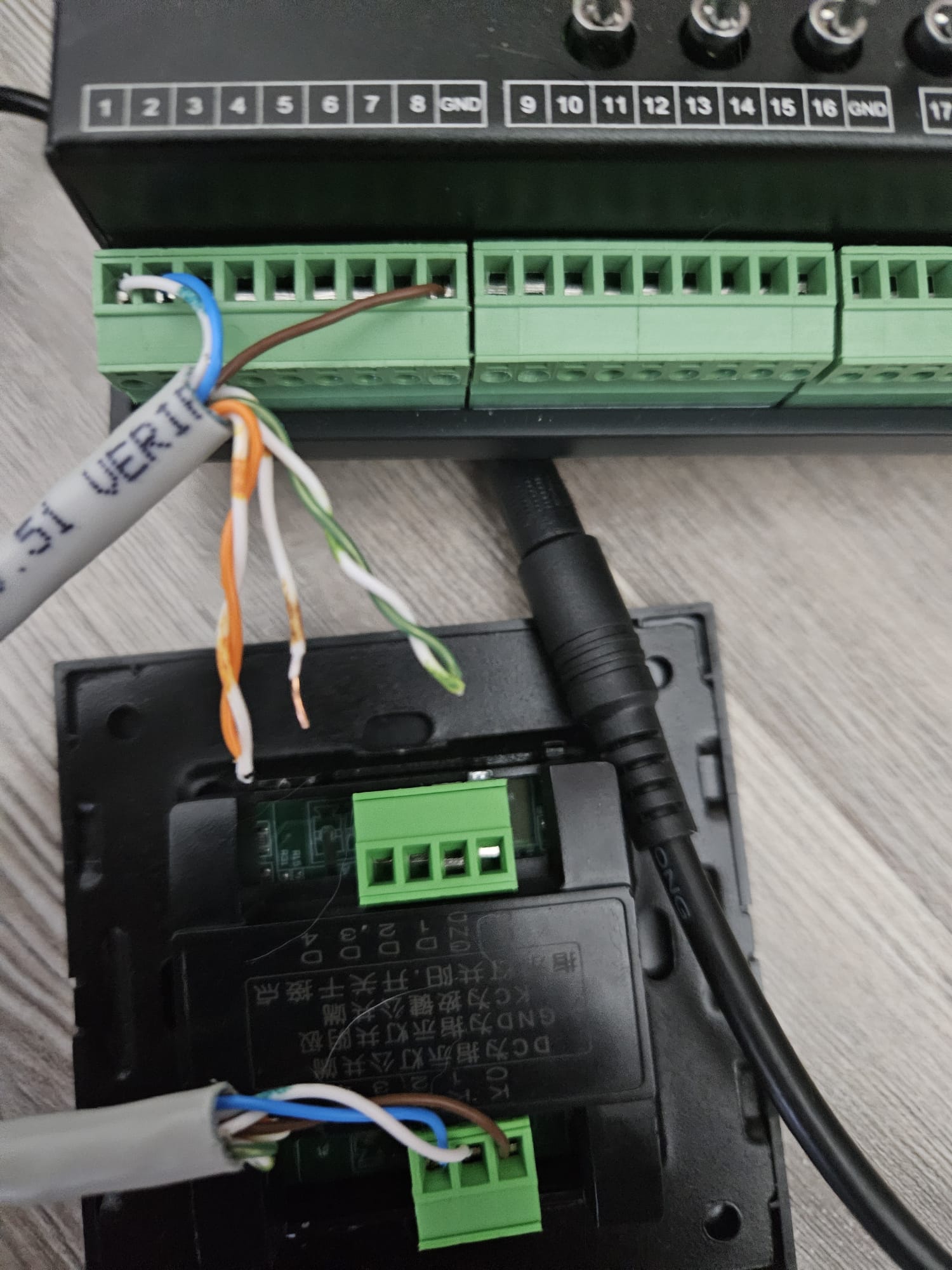

I made the wire setup - picture attached - not sure if switch should work w/o code

i have connected switch like this
KC - A32Pro GND (near the DI8)
K1 - A32Pro DI1
K2 - A32Pro DI1

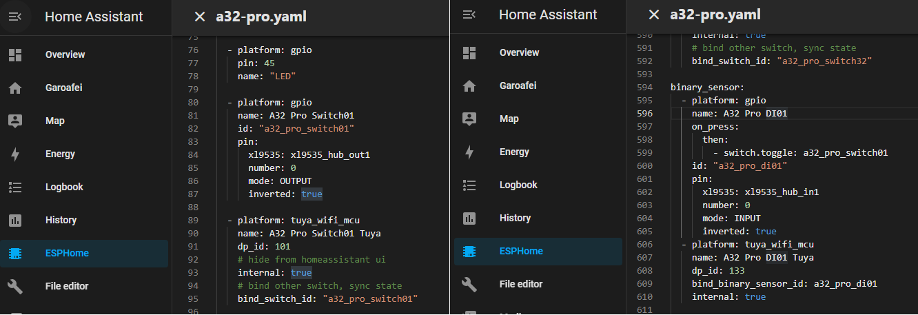

I used that code example, pasted it on my yaml file and when i press on the switch nothing happens.
When i use the switch from home assistant the red LED for switch 1 turns on so i know that works
added print screen of the setup
i have told you , you need add these to yaml, sample yaml file not have INPUT trigger OUTPUT function:
on_press:
then:
- switch.toggle: a32_pro_switch01
post your full yaml at here. You have not add this command lines.
This is my yaml file from ESPHome
.txt   ESPHome - yaml file.txt (Size: 21.93 KB / Downloads: 466)
i have tested my code, it work well.
you can use a cable short A32 Pro's digital input1 with GND. my means without your switch button for testing.
