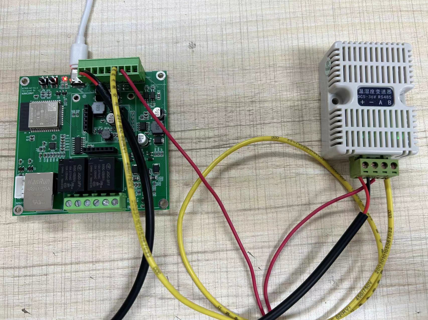

[Arduino source code for KC868-A2]-05 RS485 modbus temperature humidity sensor
  RS485 Modbus Temperature and Humidity Sensor Reader
  Made by KinCony: https://www.kincony.com
  This program reads temperature and humidity data from a Modbus RS485 sensor
  and prints the values via the Serial monitor.
  Hardware configuration:
  - RS485 communication using GPIO TX (32) and RX (35)
  - Modbus RTU protocol
  - Temperature and humidity values are stored in separate registers
  You must install the ModbusMaster library in Arduino IDE.

Do you have guide on how to install this RS485 Temperature and Humidity Sensor Modbus RTU to the new connect kcs868-A16v3 using Web GUI version 3.  I need help not able to get the reading.  Please create video if possible.  Thank you.
just download KCS v3 firmware, here is online guide: https://www.kincony.com/how-to-use-kcsv3...board.html
I goto the link still no reading.  What setting on the RS485 protocol, Modbus-RTU-v2?   I changed the Sensor to Modbus and leave all default.  No reading on the temperature at all.  Can you show me a new video oh how to connect to this unit.
KCS v3 support add modbus sensor . just go to"SENSOR" webpage, add sensor , chose "modbus", then fill regitster address and byte.
(11-05-2026, 01:40 AM)admin Wrote: KCS v3 support add modbus sensor . just go to"SENSOR" webpage, add sensor , chose "modbus", then fill regitster address and byte.
What Register, address and byte to fill in.  I leave default and it is not working at all.  What about the Protocol RS485 page?  What do I choose there?
what sensor model you have using?
