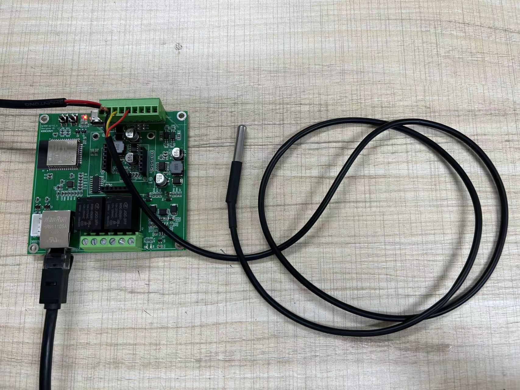

I have tested KC868-A2 board with GPIO33 for DS18B20

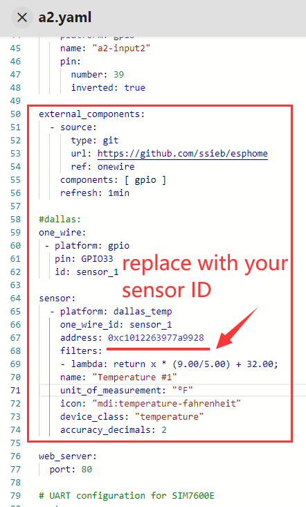

here is webpage:
here is my ESPHome config file:
you can test with my yaml file (just replace DS18B20 sensor ID by yourself):

external_components:
  - source:
      type: git
      url: https://github.com/ssieb/esphome
      ref: onewire
    components: [ gpio ]
    refresh: 1min
#dallas:
one_wire:
- platform: gpio
   pin: GPIO33
sensor:
  - platform: dallas_temp
    one_wire_id: sensor_1
    address: 0xc1012263977a9928
    filters:
    - lambda: return x * (9.00/5.00) + 32.00;
    unit_of_measurement: "°F"
    icon: "mdi:temperature-fahrenheit"
    device_class: "temperature"
    accuracy_decimals: 2

Perhaps you misunderstood me. I receive data from the sensor, but from time to time the sensor sends a warning in the logs “Scratch pad checksum invalid!” and the connection with it is lost for one sensor update interval (in my case, 5 seconds). This can happen either 3-5 minutes after launching or 15-20 minutes later, there is no regularity. To make sure that everything is fine, you need to connect the detector and leave the log for 1 hour, and then check if everything is fine. But the fact that these warnings appear in the logs must mean something. As I mentioned above, I don't get these warnings on my other D1 Mini board.
Your example didn't work either. Could something on the A2 board be damaged and affect the warnings from the DS18B20 sensor?

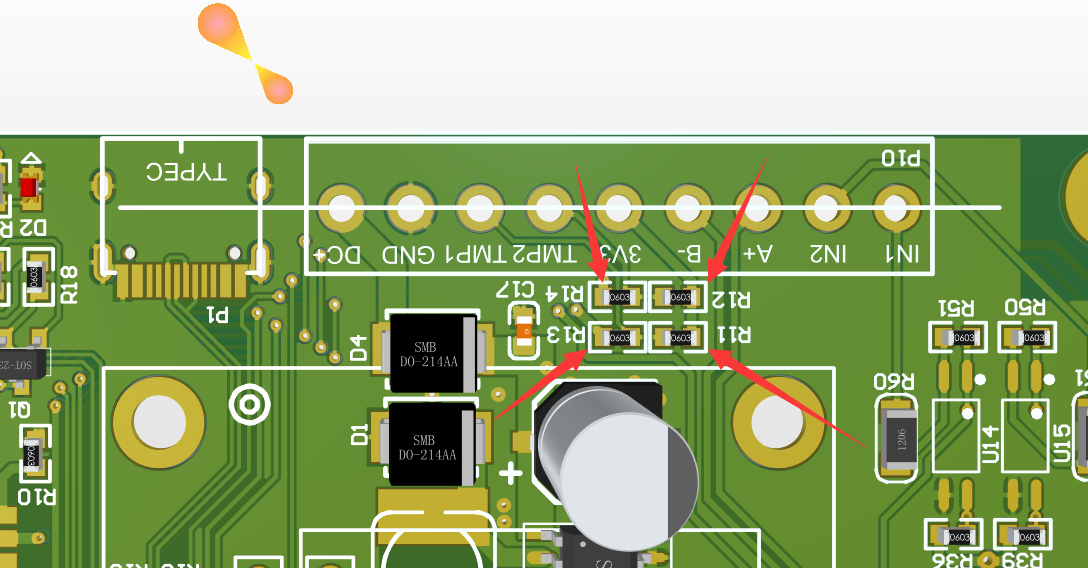

KC868-A2 1-wire circuit, only use by 4 resistance for two GPIO ports.
R11,R12: 4.7K
R13,R14: 100ohm
Maybe you can use electric ferrochrome to repair the resistor pad and the gpio pad related to the esp32 module.
#20
Hmm... can you tell me in more detail what exactly I have to do? I don't know what ferrochrome is or what to do with it.
Are you suggesting that there might be a problem with the resistors? I can solder other 4.7K and 100Ω resistors in their place, but I have standard resistors with legs, not SMD. But before that, can I somehow make sure that the resistors on the board are not working properly?
