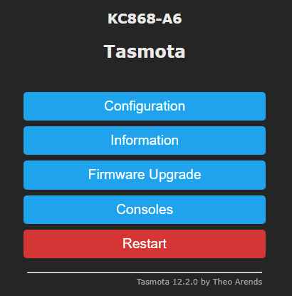

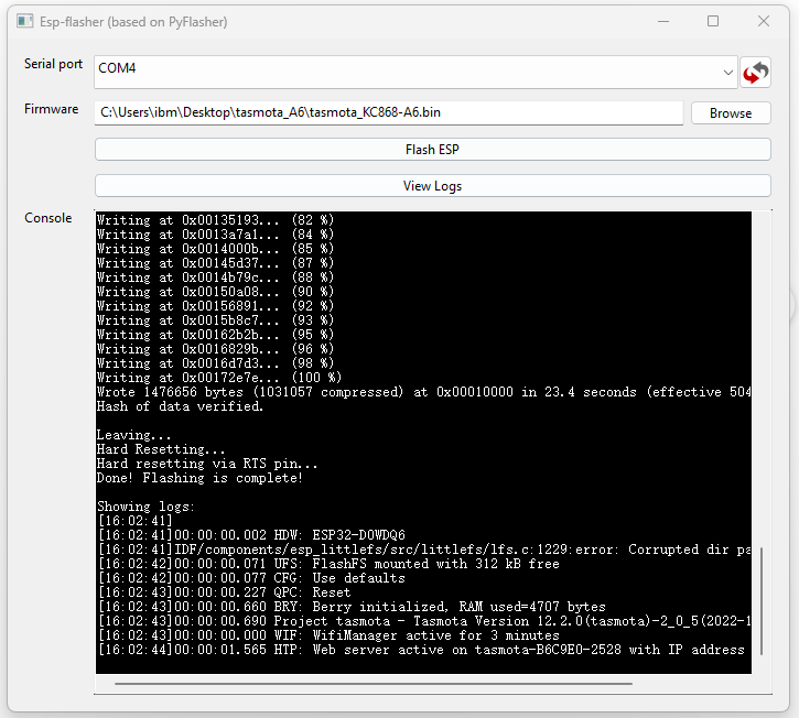

how to use tasmota firmware with KC868-A6
firmware:
.zip   tasmota_KC868-A6.zip (Size: 991.5 KB / Downloads: 1,553)
this firmware have enabled SSD1306 display.
.zip   kc868-a6-tasmota-ssd1306_firmware_11_25_09.zip (Size: 997.58 KB / Downloads: 1,148)
very welcoming , now everything works fine , thank you
update new version with enable SSD1306 display, first button renamed by "LCD".
.zip   tasmota_KC868-A6-20221128.zip (Size: 997.56 KB / Downloads: 1,286)

For me it worked by initially installig the tasmota firmware and then, inside the device using "firmware upgrade".
Start by this https://www.youtube.com/watch?v=Yk_R2RgUWI8&t=1s
then go to firmware upgrade once you are inside and install this one provided here.

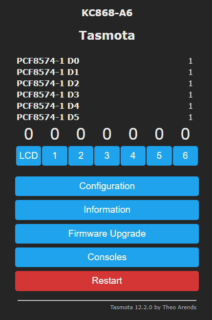

(11-28-2022, 10:39 AM)admin Wrote: update new version with enable SSD1306 display, first button renamed by "LCD".
is this firmware can't work for you??

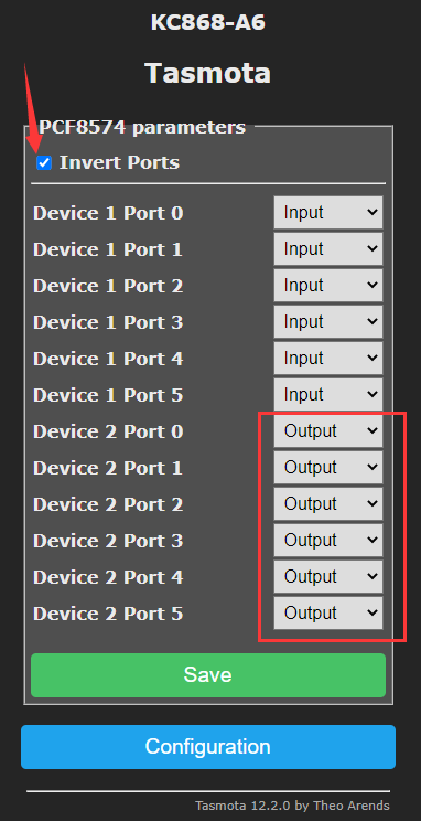

The firmware you provided suscesfully displays the PCF8574 relays and also shows the LCD button.
the problem is that as soon as you upgrade trasmota (now to 14.4.1 version) it breaks the lcd and relay configuration.
I know it is not related to you, but it would be nice to know which modificationd did you make to the software so we can do it whenever a new version comes up .
just enabled PCF8574 and SSD1306 when compile tasmota firmware. when have free time can make a new firmware.
