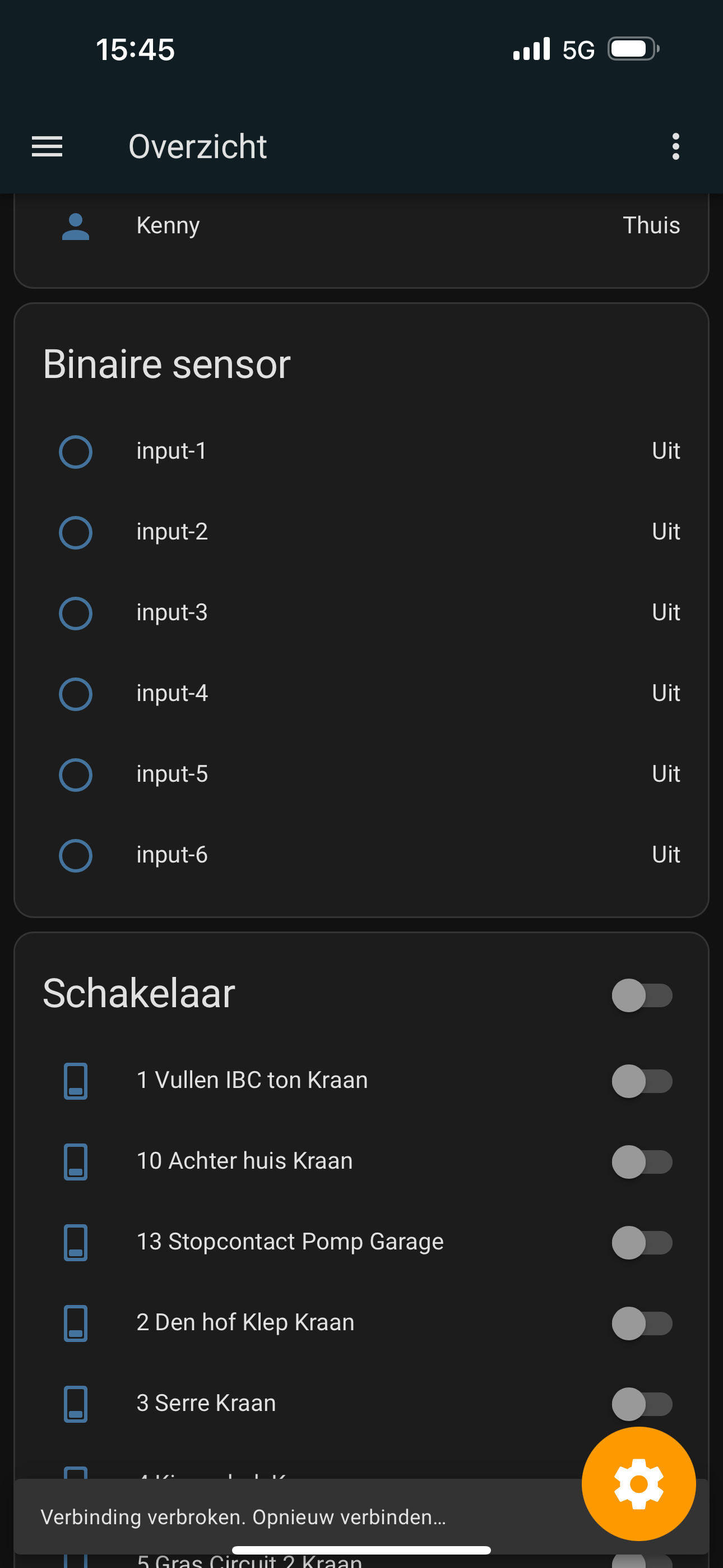

I'm struggling with the integration of the H32B Pro controller into Home assistant via MQTT on Ethernet.
So I followed all the steps like in your video (https://www.youtube.com/watch?v=wMkQccSFY3A&t=406s )
But I cannot see any entity of the relay inputs/Outputs.
Instead in the log files I get fault messages on the configuration code:
Logger: homeassistant.config
Source: config.py:1300
Invalid config for 'mqtt' at configuration.yaml, line 13: 'broker' is an invalid option for 'mqtt', check: mqtt->0->broker, please check the docs at https://www.home-assistant.io/integrations/mqtt Invalid config for 'mqtt' at configuration.yaml, line 13: 'password' is an invalid option for 'mqtt', check: mqtt->0->password, please check the docs at https://www.home-assistant.io/integrations/mqtt Invalid config for 'mqtt' at configuration.yaml, line 13: 'port' is an invalid option for 'mqtt', check: mqtt->0->port, please check the docs at https://www.home-assistant.io/integrations/mqtt Invalid config for 'mqtt' at configuration.yaml, line 13: 'username' is an invalid option for 'mqtt', check: mqtt->0->username, please check the docs at https://www.home-assistant.io/integrations/mqtt
In the file editor I added the configuration code with the Broker IP adress of the Raspberry pie 5 it's running on, and filled in the correct UID.
Here is what I filled in:
/homeassistant/configuration.yaml
mqtt:
broker: 192.168.0.25
port: 1883
username: mqtt
password: 123
switch:
- name: 'output-1'
unique_id: output-1
state_topic: 'relay32/582284c1f1ea0c0db02022b1/state'
command_topic: 'relay32/582284c1f1ea0c0db02022b1/set'
payload_on: '{"relay1":{"on":1}}'
payload_off: '{"relay1":{"on":0}}'
value_template: '{{ value_json.relay1.on }}'
state_on: 1
state_off: 0
I installed the Mosquitto broker and the MQTT integration I can't see what Im missing here
