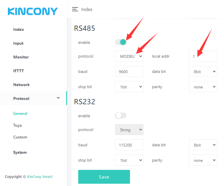

do you want send single command to read everyone register? or use one command to read all INPUT register?
tested with KCS firmware, enabled rs485 modbus as follows, INPUT1 (key1) is no problem. see the photos.
INPUT 1-35 begin with RS485 register 0
tested with key4 ,also is well.  bit "0" means "pressed".
