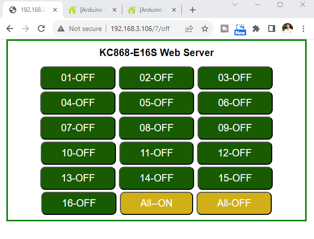

* Create Your own WebServer for KC868-E16S Smart Controller*
* https://www.kincony.com **

// Display the HTML web page
client.println("<style>html { font-family: Helvetica; display: inline-block; border: 3px solid green;margin: 0px 15px;text-align: center;font-size: 10px;}");
if (flag_read_di==1)
client.println(" relay1:" + relay1state + " relay2:" + relay2state + " relay3:" + relay3state + " relay4:" + relay4state + " relay5:" + relay5state + " relay6:" + relay6state + " relay7:" + relay7state + " relay8:" + relay8state + " relay9:" + relay9state + " relay10:" + relay10state + " relay11:" + relay11state + " relay12:" + relay12state + " relay13:" + relay13state + " relay14:" + relay14state + " relay15:" + relay15state + " relay16:" + relay16state);
else
// Web Page Heading
client.println("<body><h1>KC868-E16S Web Server</h1>");
if (relay1state == "off") client.println("<a href=\"/1/on\"><button class=\"button\">01-OFF</button></a>"); else client.println("<a href=\"/1/off\"><button class=\"button\">01--ON </button></a>");
if (relay2state == "off") client.println("<a href=\"/2/on\"><button class=\"button\">02-OFF</button></a>"); else client.println("<a href=\"/2/off\"><button class=\"button\">02--ON </button></a>");
if (relay3state == "off") client.println("<a href=\"/3/on\"><button class=\"button\">03-OFF</button></a>"); else client.println("<a href=\"/3/off\"><button class=\"button\">03--ON </button></a>");
if (relay4state == "off") client.println("<a href=\"/4/on\"><button class=\"button\">04-OFF</button></a>"); else client.println("<a href=\"/4/off\"><button class=\"button\">04--ON </button></a>");
if (relay5state == "off") client.println("<a href=\"/5/on\"><button class=\"button\">05-OFF</button></a>"); else client.println("<a href=\"/5/off\"><button class=\"button\">05--ON </button></a>");
if (relay6state == "off") client.println("<a href=\"/6/on\"><button class=\"button\">06-OFF</button></a>"); else client.println("<a href=\"/6/off\"><button class=\"button\">06--ON </button></a>");
if (relay7state == "off") client.println("<a href=\"/7/on\"><button class=\"button\">07-OFF</button></a>"); else client.println("<a href=\"/7/off\"><button class=\"button\">07--ON </button></a>");
if (relay8state == "off") client.println("<a href=\"/8/on\"><button class=\"button\">08-OFF</button></a>"); else client.println("<a href=\"/8/off\"><button class=\"button\">08--ON </button></a>");
if (relay9state == "off") client.println("<a href=\"/9/on\"><button class=\"button\">09-OFF</button></a>"); else client.println("<a href=\"/9/off\"><button class=\"button\">09--ON </button></a>");
if (relay10state == "off") client.println("<a href=\"/10/on\"><button class=\"button\">10-OFF</button></a>"); else client.println("<a href=\"/10/off\"><button class=\"button\">10--ON</button></a>");
if (relay11state == "off") client.println("<a href=\"/11/on\"><button class=\"button\">11-OFF</button></a>"); else client.println("<a href=\"/11/off\"><button class=\"button\">11--ON</button></a>");
if (relay12state == "off") client.println("<a href=\"/12/on\"><button class=\"button\">12-OFF</button></a>"); else client.println("<a href=\"/12/off\"><button class=\"button\">12--ON</button></a>");
if (relay13state == "off") client.println("<a href=\"/13/on\"><button class=\"button\">13-OFF</button></a>"); else client.println("<a href=\"/13/off\"><button class=\"button\">13--ON</button></a>");
if (relay14state == "off") client.println("<a href=\"/14/on\"><button class=\"button\">14-OFF</button></a>"); else client.println("<a href=\"/14/off\"><button class=\"button\">14--ON</button></a>");
if (relay15state == "off") client.println("<a href=\"/15/on\"><button class=\"button\">15-OFF</button></a>"); else client.println("<a href=\"/15/off\"><button class=\"button\">15--ON</button></a>");
if (relay16state == "off") client.println("<a href=\"/16/on\"><button class=\"button\">16-OFF</button></a>"); else client.println("<a href=\"/16/off\"><button class=\"button\">16--ON</button></a>");
client.println("<a href=\"/all/on\"><button class=\"button\">All--ON</button></a>");
