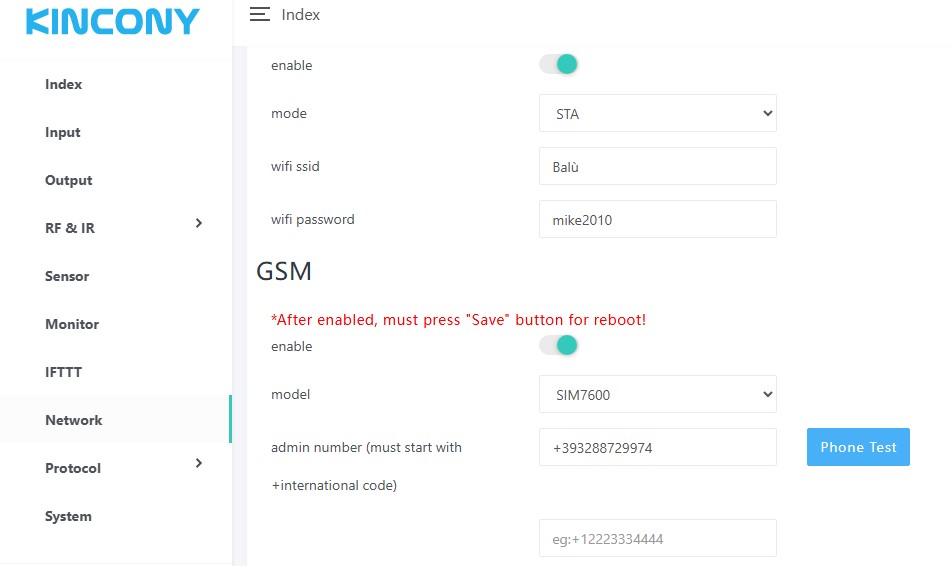

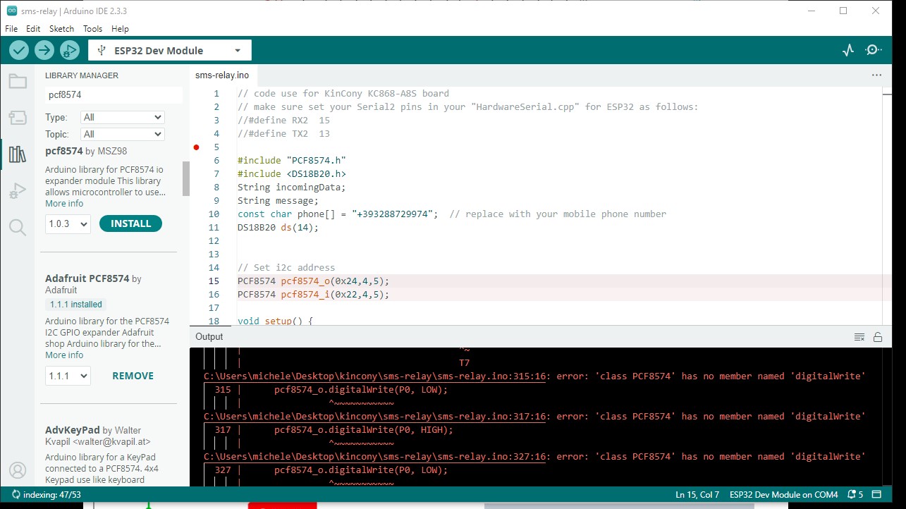

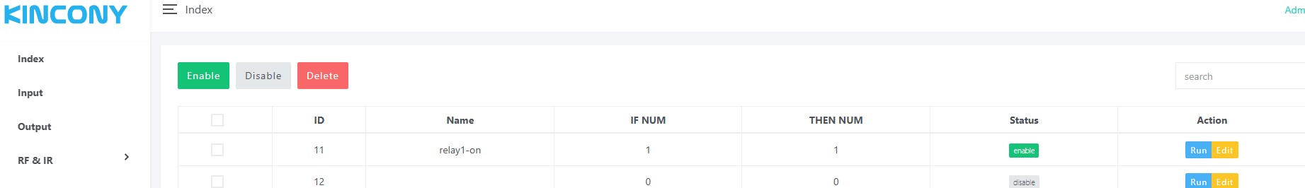

Good morning, I am programming your KC868-A8S V1.2 board that I purchased for my uses, I can receive SMS and notification calls, but I can't control the relays with SMS and calls. I did the programming through the IFTTT screen and wrote the relative SMS on the network SMS control screen, but it doesn't work. Same thing with the calls. I also tried through the Arduino IDE 2.3.3 sketch with the sms-relay.ino file, but despite loading the required libraries, when I upload and compile it makes an infinite number of errors. For me it is very important to be able to use the SMS commands to control the relays. I attach some screenshots. I await your feedback. Thanks
1. when you using KCS firmware, do you use "+393288729974" mobile phone send SMS to KC868-A8S? because of only can receive manager's phone number's SMS.

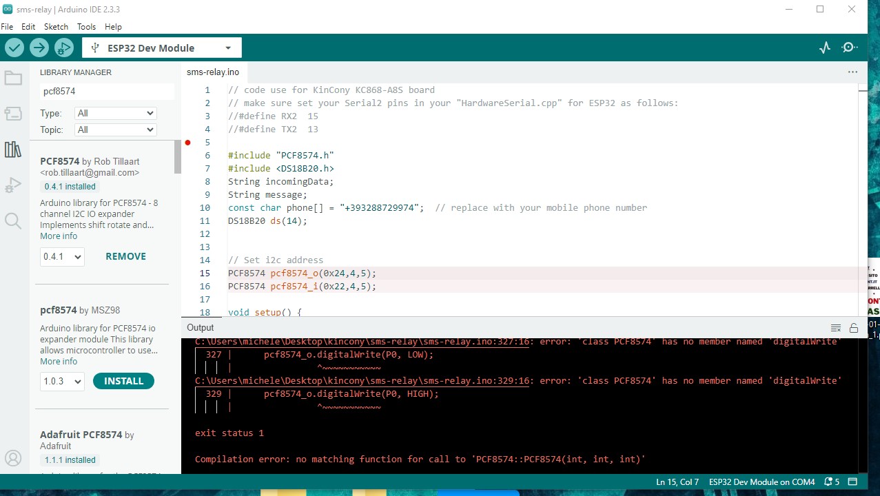

2. here is PCF8574 Arduino library we are using.
.zip   PCF8574_library.zip (Size: 23.8 MB / Downloads: 723)

Yes I use that number to send and make calls.

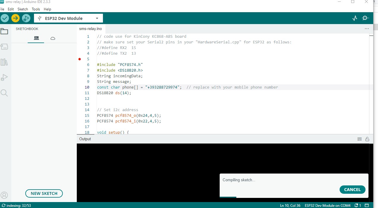

Now I tried the sketch again using the library you sent me PCF8574_library and it worked until the end.

Can the card KC868-A8S v.1.2 be programmed with kcs for control sms and calls? I tried, but it only makes calls and sms notifications from the card to the phone

One question, is it ok to program SMS and calls through KCS with IFTTT without using the Arduino sketch?
Thanks
sure, you can config IFTTT for send SMS, make CALL. or receive SMS , receive CALL. without arduino code.
