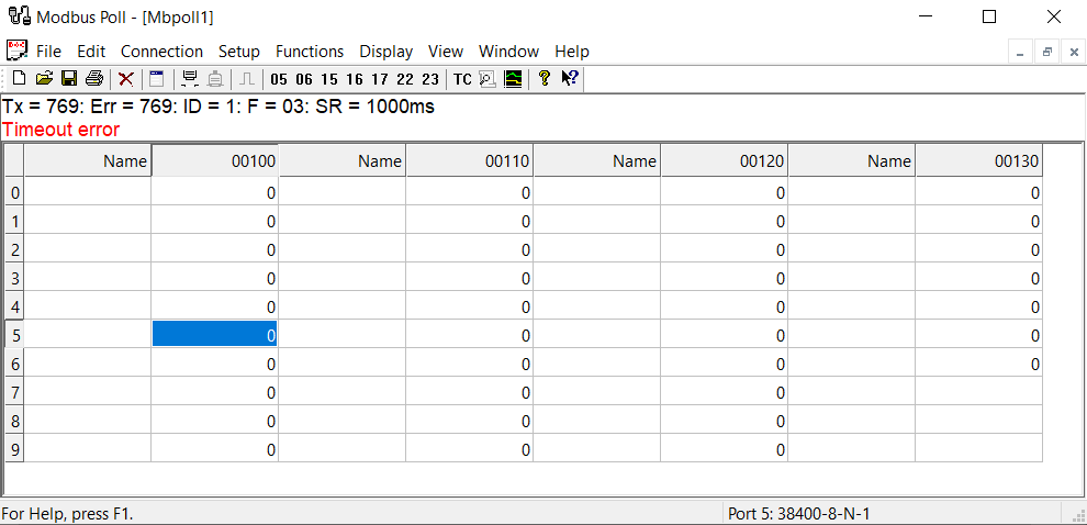

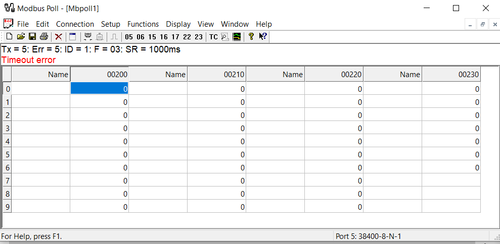

-- Connecting  modbus pull with same configuration as in yaml file { uart:   id: modbus_uart  rx_pin: 32  tx_pin: 33  baud_rate: 115200  stop_bits: 1  data_bits:   parity: NONE}   it shows timeout error with no readings?

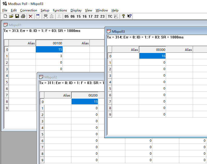

you can use modbus pull to read original data from RS485 firstly. I have not see you connect AC220V (L and N) with 3 VOLTAGE terminal.
connected the 3 terminal to power line as advised but same problem ! no sensor reading and timeout error in modbus
any further suggestions ?

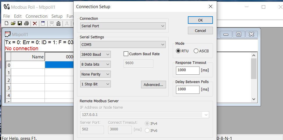

take a photo of your COM port setting in modbus, such as baud rate whether is 38400bps?
yes its the same as in your previous post
