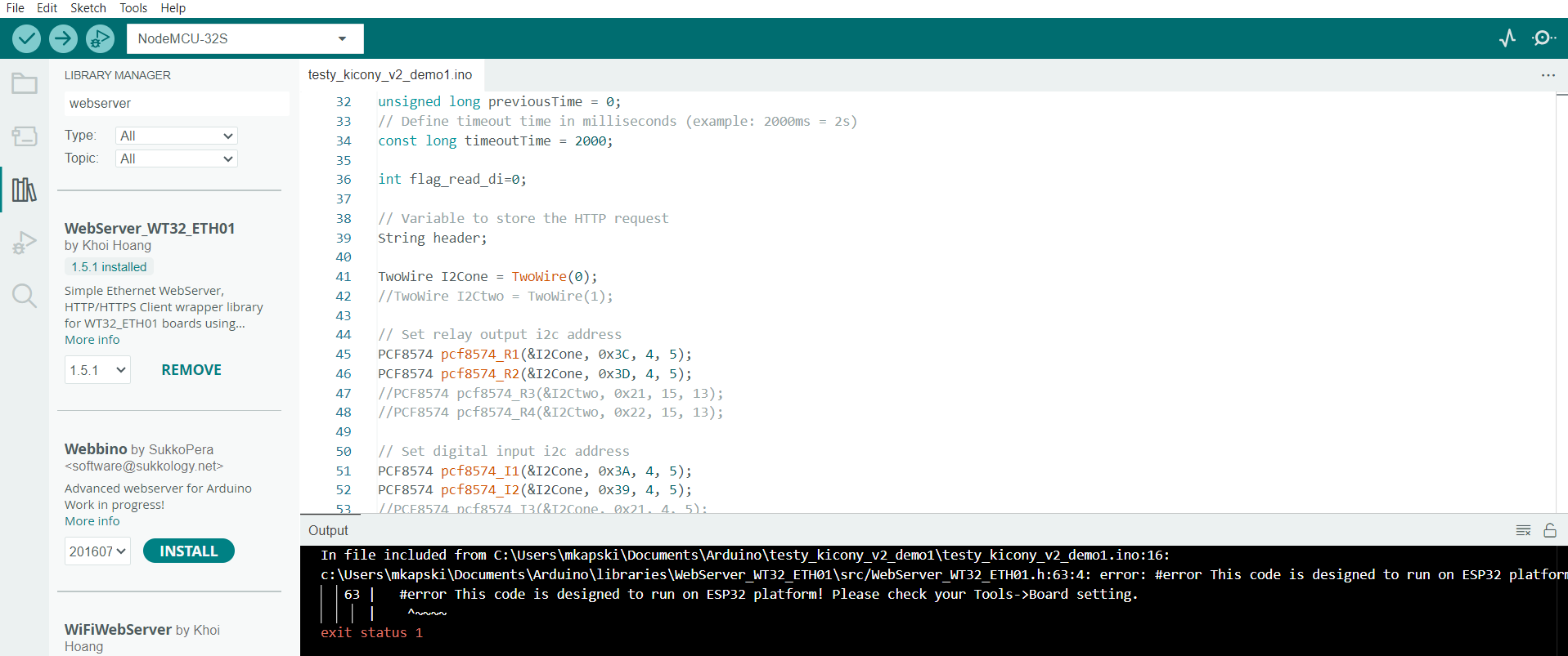

When I try to compile the example I get the messageConfusedrc/WebServer_WT32_ETH01.h:63:4: error: #error This code is designed to run on ESP32 platform! Please check your Tools->Board setting.
Espressif ESP32 installed (boards). Selected board ESP32 S3 Box or WT32-ETH1. Regardless of which board variant I choose - I get the same message. Any tips?
Arduino:2.3.3, ESP 3.0.7. file: HelloServer.ino

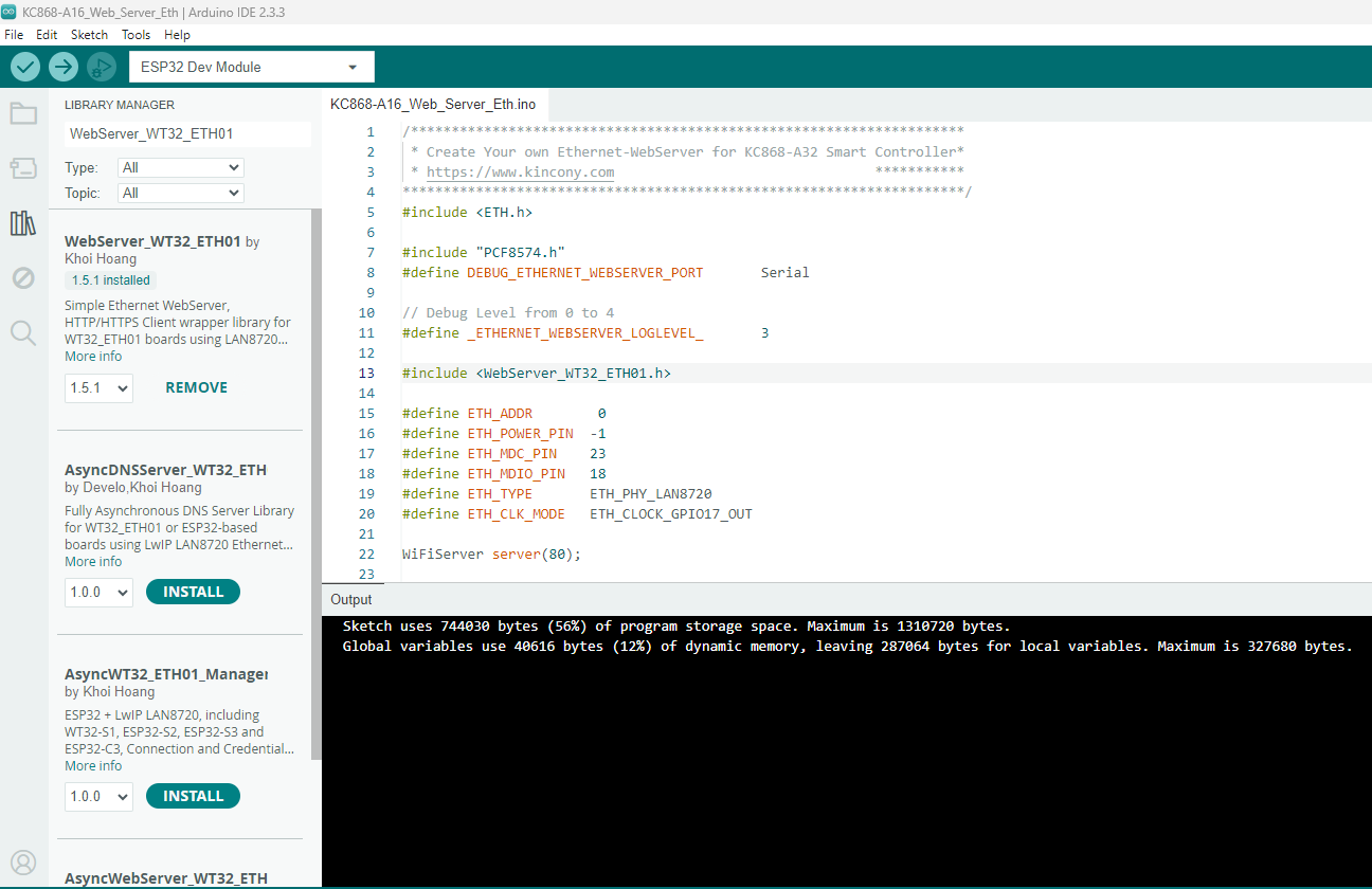

I have the WebServer_WT32_ETH01 library installed, the problem lies in the STM32 definition in the code of this library. Just change the line #if ESP32 to #if !ESP32 and the compiler goes on. However, there is another problem with the PCF8547 library.. in the second picture.
Probably you have to use Renzo Mischianti's PCF8574 library. Now the problem is the ETH.h library - which one to use? I have installed https://docs.arduino.cc/libraries/ethernet/ in newest version but I see that the esp32 library has its own ETH.h (so I uninstalled my) libraries. It says that constants should be defined, for example:

here is PCF8574 arduino library we are using.
.zip   PCF8574_library.zip (Size: 23.8 MB / Downloads: 1,061)
(11-14-2024, 12:36 PM)admin Wrote: here is PCF8574 arduino library we are using.
PCF problem solved. What about ETH.h library and compiler errors? Which library should I use? Currently the one built into the esp32 library is used, which can be seen in the error logs.
