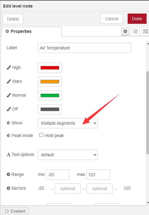

is this part in Node-Red?
All four colors for stripes can be customized. In addition, there is three options to modify the colors of the level bar. Multiple segments - Colors tied to stripes according to sector values. Single color bar - Single value-based color for all active stripes. Interpolated colors - Colors interpolated from normal to high color. If you choose Multiple segments for your stripe colors, you can optionally use the Peak mode.

Examples of msg.control usage
msg.control = {min:10, max:80} to change min and max values. msg.control = {min:10, max:80, seg1:30, seg2:60} to change min, max and segments all together. msg.control = {seg2:60} to change high segment value only.
details about level node:
https://flows.nodered.org/node/node-red-...b-ui-level
