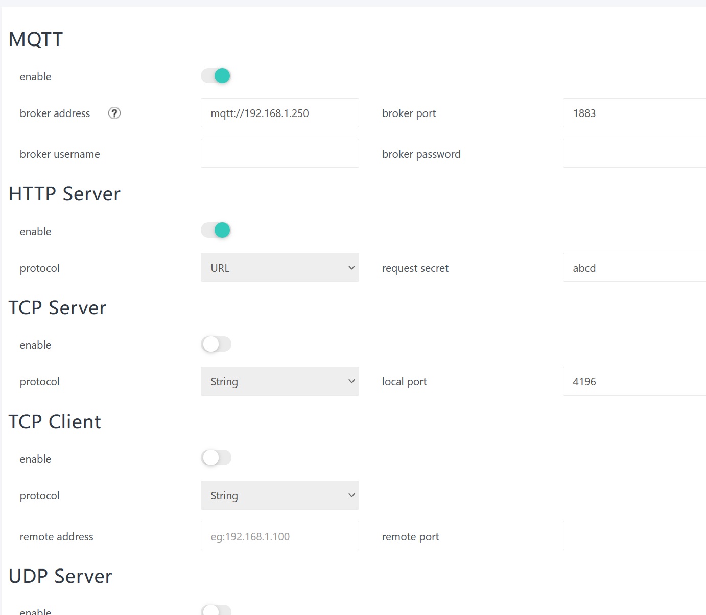

256
take a photo of your protocol webpage setting of KCS firmware.

(12-24-2024, 11:59 PM)admin Wrote: take a photo of your protocol webpage setting of KCS firmware.
Hello Admin,
Thank you.
Here is my parameters.
By the way, I don't know why I do not have access to the Modbus parameters, this board should be compatible with Modbus RTU, right ?

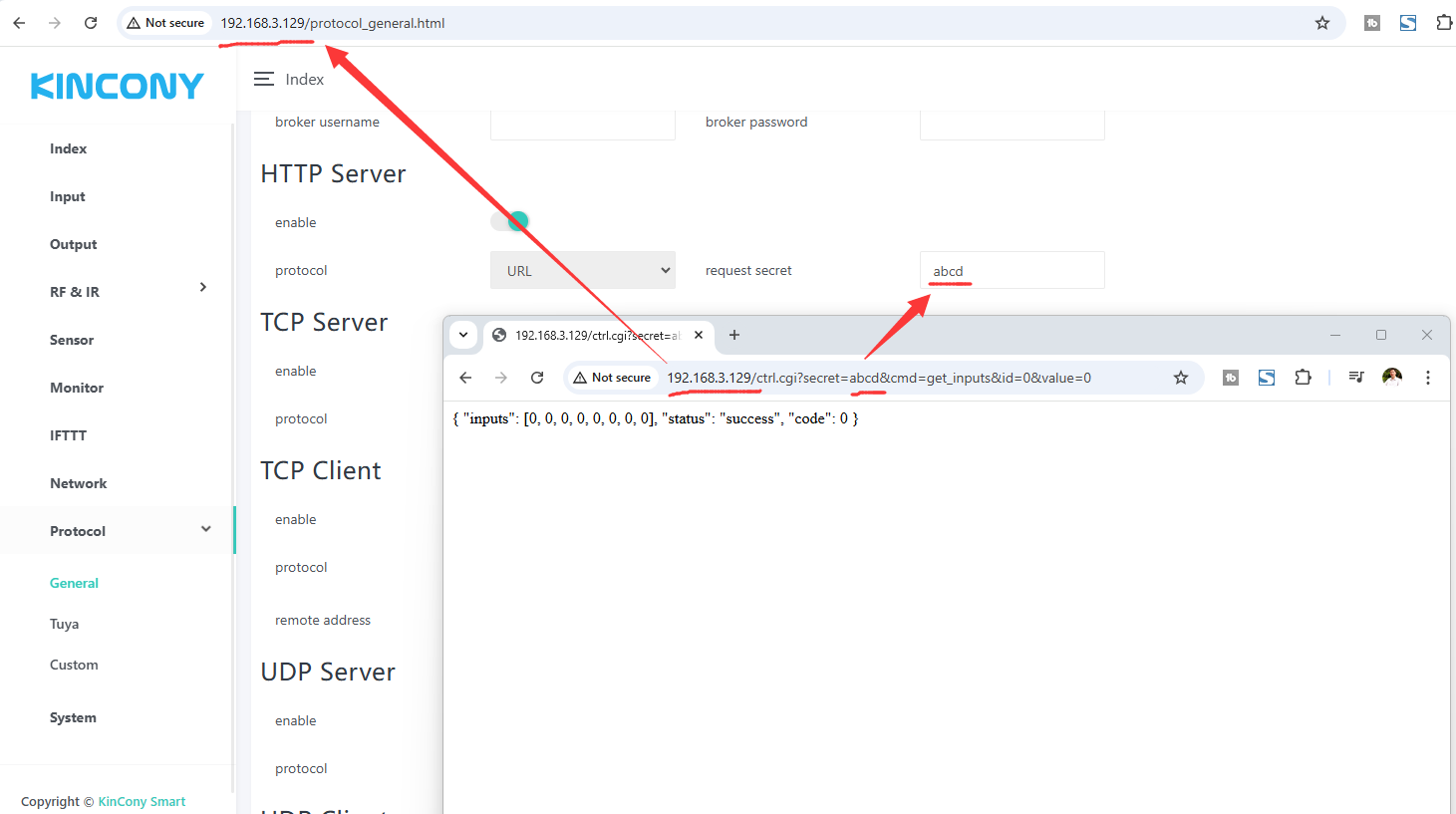

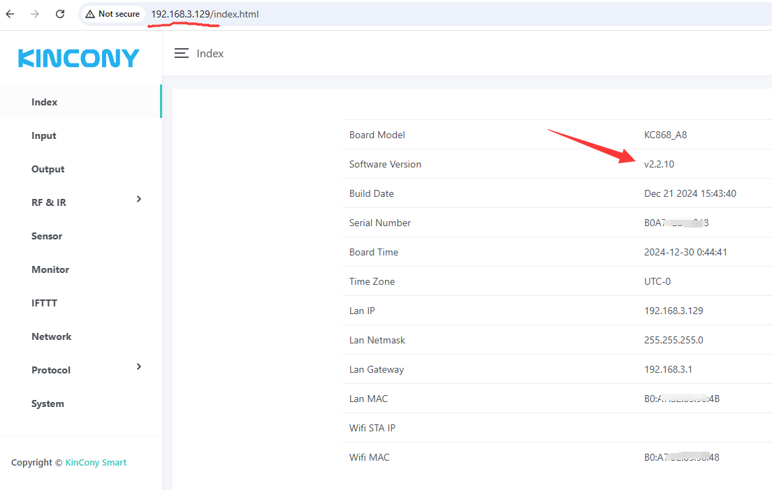

Posts: 10,212
Threads: 1,473
256
i have tested the newest firmware V2.2.10, it's work well, make sure, you can replaced your actually ip address of your KC868-A8 board.
