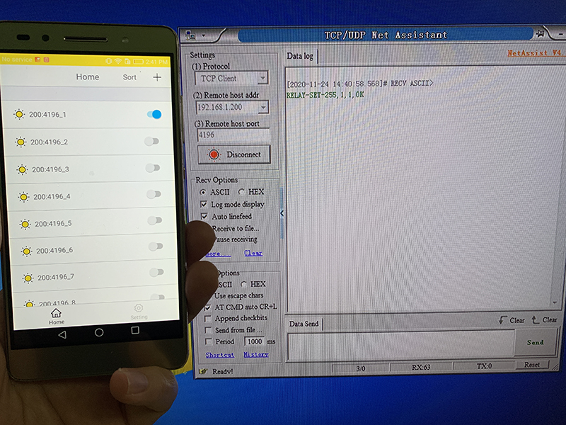

#26
this is test photo. what's your KC868-H32B controller firmware version?

#28
give me your email? I send you new firmware, you can download by RS232 port , it will be support this feedback function.
how to download , see this video: https://youtu.be/LLIJe9VTVq8
this is new firmware details: https://www.kincony.com/forum/showthread.php?tid=9
#29
Controller firmware updated to version 3.3 and synchronization of switch status between Node-Red, Google Home and KBOX Smart applications works without any problems.
