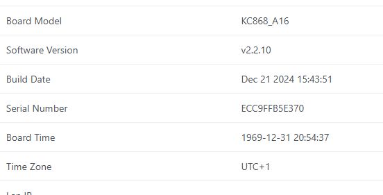

Hello
i have a problem with the NFP, in fact impossible to have a correct display with the right time zone.
What is the reading cycle of the NTP server?
The internet connection is good.
This NTP server works well on all my computers
The capture 3 is the time of my computer
Regards

Hi,
Ok with the firmware,
but for me there is still another problem
If we restart the card the time is not up to date
1.After a rest you have to read the NTP server immediately to have the time and synchronize with the other equipment.
2. what is the reading cycle of the NTP server?
JL
For me it is not stable.. I have the impression that this happens when there is a static IP, can you see on your side.

after 1h30 still not up to date

can you replace some other NTP server for a testing. such as:
europe.pool.ntp.org
0.europe.pool.ntp.org

Thank you very much
However I don't understand why it doesn't work with time.google
I use it elsewhere.
The main thing is that it works.
Can you tell me the frequency of reading the NFP? (for the summer/winter time change)
Thank you

just when power on of board, will read it from internet.

Maybe we should plan a cycle every hour, otherwise it will never be on time in Europe with the time change in March and October?

will save your suggestion. But now new board KC868-A16v3 will use local RTC DS3231 chip, not need internet.
