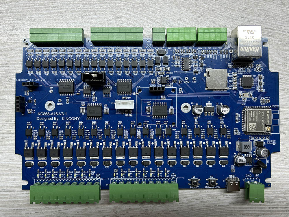

If you make bulk purchases, you can design a new firmware about it based on KC868-A16v3 new PCB.

my means, if you order new board at a large number in future, we can modify the firmware.
